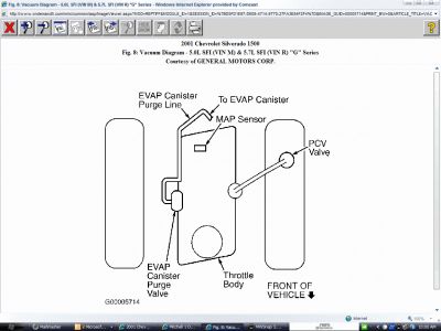

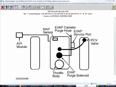

DOES THIS VEHICLE HAVE A PCV VALVE AND WHERE IS IT? CHECY SILV 2001 8CYL.
Dec 26, 2007 at 8:24 AM
MERLIN2021
  • 17,250 POSTS
Two out of three do have one, 8.1 I do not see one in the vac diagrams.
https://images.2carpros.com/forum/automotive_pictures/62217_PCV_1.jpg
https://images.2carpros.com/forum/automotive_pictures/62217_PCV1_2.jpg
