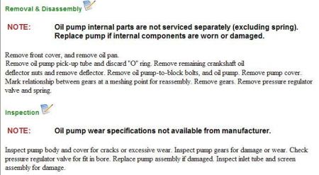

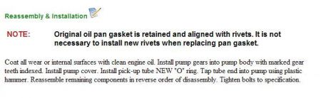

how to remove an oil pump
Saturday, October 31st, 2009 AT 7:29 PM
BLUELIGHTNIN6
MECHANIC
16,542 POSTS
SPONSORED LINKS
Saturday, October 31st, 2009 AT 7:34 PM
