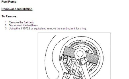

replacing fuel pump
Saturday, April 4th, 2009 AT 8:39 AM
JDL
MECHANIC
16,098 POSTS
You need to drain the tank, first.
