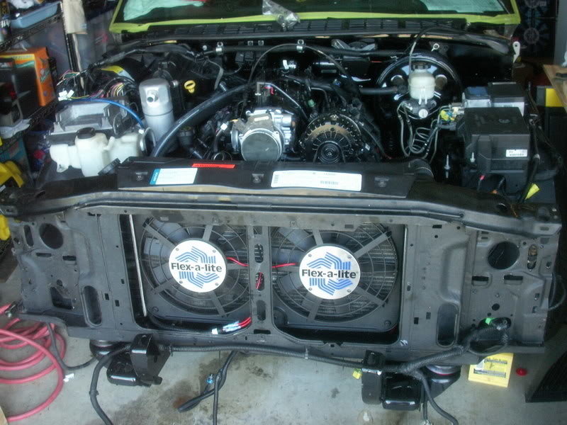

As far as vacuum leaks, I've checked all the hoses I could find and didn't find anything. However I did find some part that I don't know what it is on top of the manifold that is very loose. Showed the guy at autozone and he said he'd seen this before and that it was a bad design by GM and I'd have to agree because it had only one bolt holding it on. I took it off and he said he saw a crack on the bottom, but I wasn't sure it just wasn't dirt. ONly a 35$ part so I would've just changed it there but they didn't have the part. Do you know what this is? Here's a picture I found online where its visible. Its the vertical piece on top of the manifold just behind the throttle body that looks like it has a spark plug type wire connected to it on top.

The part is your EVAP purge solenoid.
