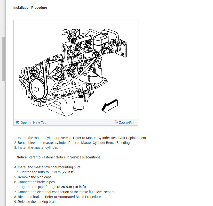

Rear pads wear prematurely, less than 4,000 miles. Pads wear evenly inside and out, both sides of vehicle. New rotors, several pad replacements. One caliper replacement. New rear inner and both outer flex brake lines have been replaced. Parking brake shoes replacement as well.
Jan 23, 2010 at 3:44 AM

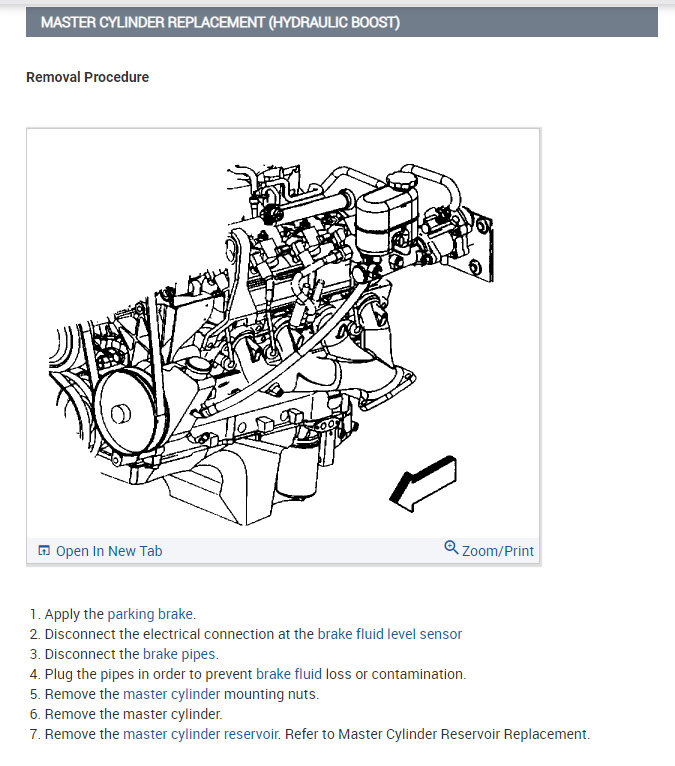

More than likely this is a master cylinder issue because the fact that they are wearing evenly and on both sides that points to the fact that it has to be something that effects both sides equally.
Here is a guide that will help with replacing the master:
https://www.2carpros.com/articles/how-to-replace-a-brake-master-cylinder
I am attaching the info below from the manual. Just make sure you bench bleed the master before you put it in.
Run through this material and let me know if you have questions. Thanks
