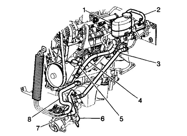

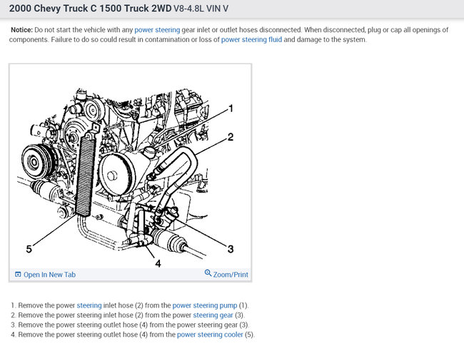

Is there a diagram for the hoses of a steering pump for my truck

it should only have two hoses. A pressure and a return hose, unless you have a hydro-boost brake system. Check out the diagrams (Below). Please let us know if you need anything else to get the problem fixed.
