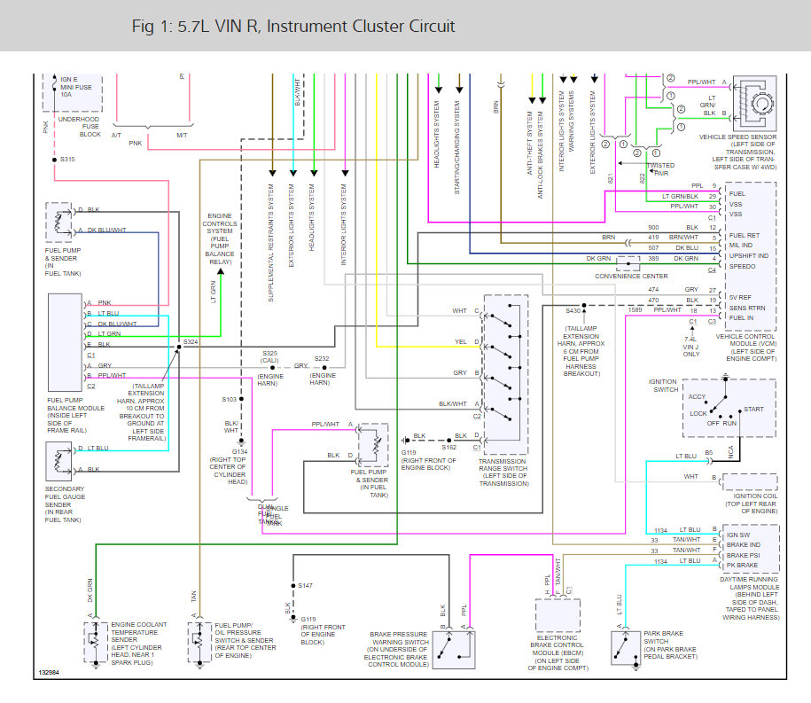

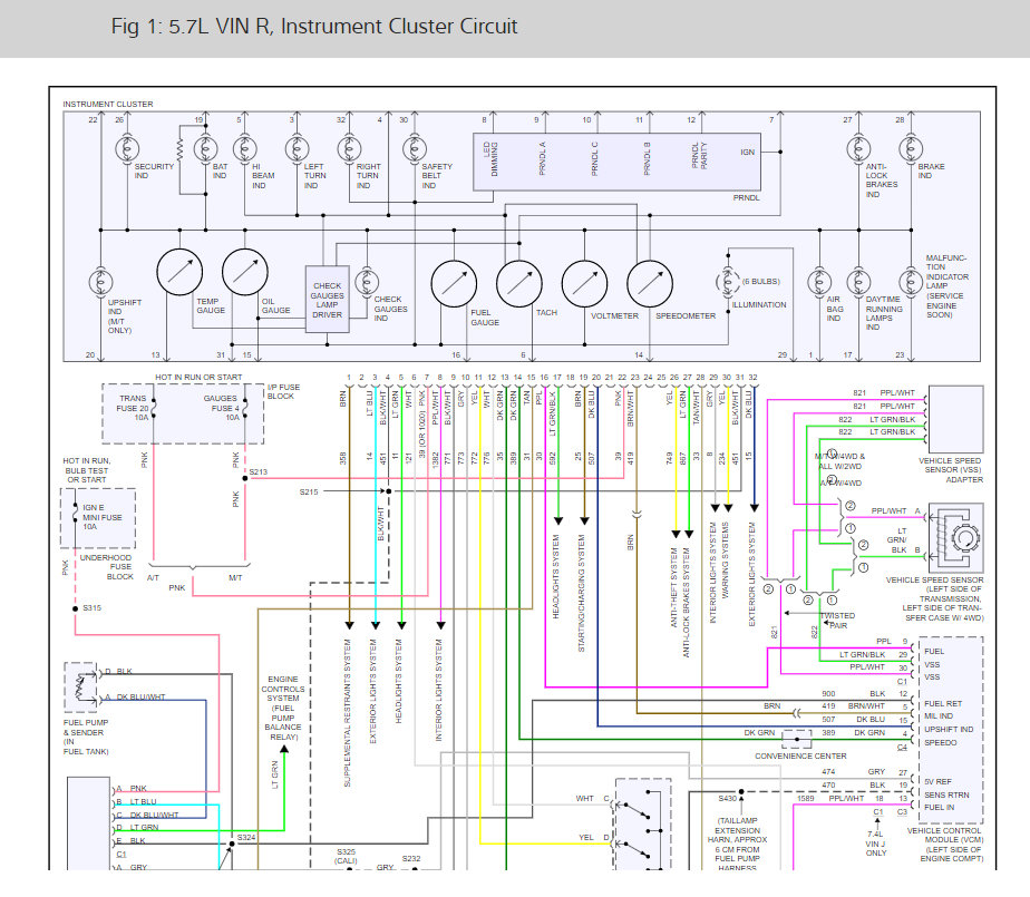

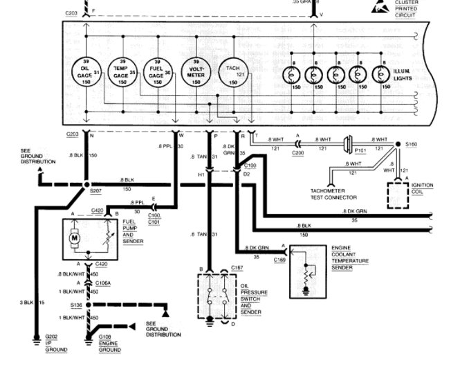

Recently my instrument cluster started acting weird. It will be fine and then hit a bump or vibration and the gauges go wild. Speedometer goes up and down, others jump around. This happens for a little while and then they straighten up until a bump is hit again. What's wrong? Short or cluster bad?
Nov 7, 2010 at 12:56 PM
  • 110,244 POSTS
It sounds like the cluster is bad you can send it out to have it rebuilt here is a video showing you how to remove the cluster. This is common problem. Also check the grounds for the cluster as well. Here is a guide and the instrument cluster wiring diagrams below.
https://youtu.be/_HEC44xENxw
and
Check out the diagrams (Below). Please let us know what you find. We are interested to see what it is.

I had a problem with my dash(the gauges were all over the place) I found it was the cluster ground wire broken at the back of the right engine head. I simply re-grounded it at an other location. This wire quite often breaks from age or does not get bolted back on if there is head work done as it is tought to get at and even harder to see. Reach down behind the head and feel around to find the bolt with a wire eyelet on the head and one or two black wires.

The ground wiire for the dash comes from the dash plug, through the firewall on the left side and over to the right side behnd the engine. It is connected to the back of the engine head. You probably wont be able to see it, but if you put your hand between the firewall and the head you should be able to find the wires. I dont why the dash is grounded to the engine, and of all places here, but I just connected a piece of wire and ran it to the front of the engine and grounded it to the block.

This worked for me. Wires are in a plastic sheath and were just hanging there. Added a length of wire and a connector and grounded to an easily accessible bolt..bingo! All gauges now working properly

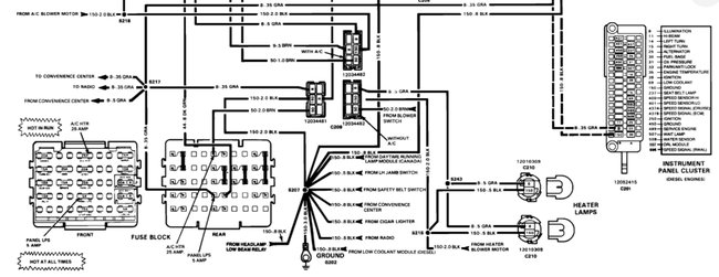

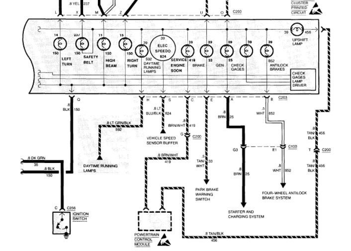

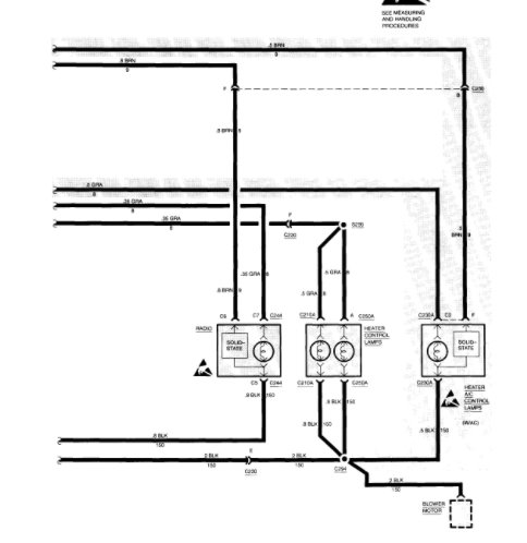

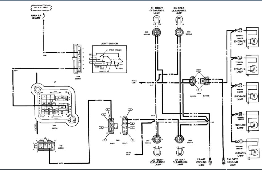

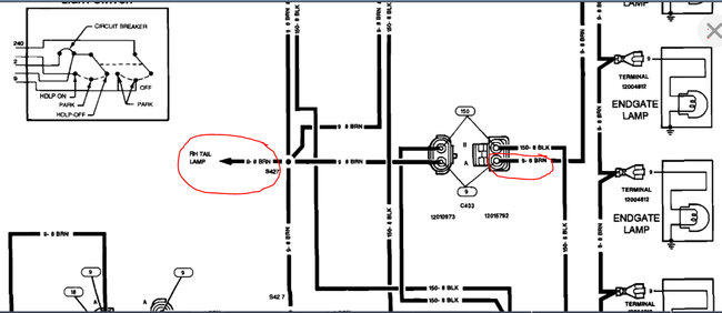

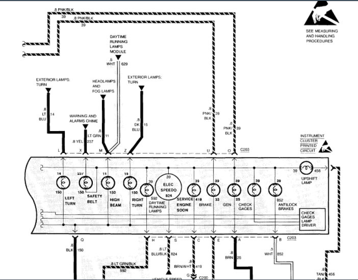

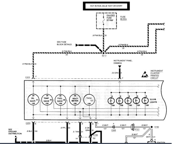

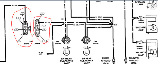

I am trying to take out of my Chevrolet 1990 moonie cluster and put one of silverado 1994 but need diagramas of two cluster to know how to rewire it.
Jun 2, 2021 at 5:43 AM (Merged)
DANNY L
  • 5,648 POSTS
Hello, I'm Danny.
Here is the information you requested. This is a tutorial showing how to test electrical wiring:
I've attached the 1990 and 1994 Chevrolet truck instrument cluster wiring diagrams below. I've cut the pictures in half so you can view larger. You will not have to splice wires to make this work but instead you will have to re-pin, relocate wires around in the connector to make the '94 style cluster work. I know a lot about the '88-98 body style as I've owned a few myself. Just an FYI is if you get a '91 cluster with the newer needle style display it also has an RPM gauge and is completely plug-n-play requiring no rewiring. I was in the process of doing this until my '89 K1500 got stolen. I was getting rid of my moonies and putting in a '91 cluster with needle style and RPM gauge. Attached a picture below. Let us know if you have any other questions about this. Hope this helps and thanks for using 2CarPros.

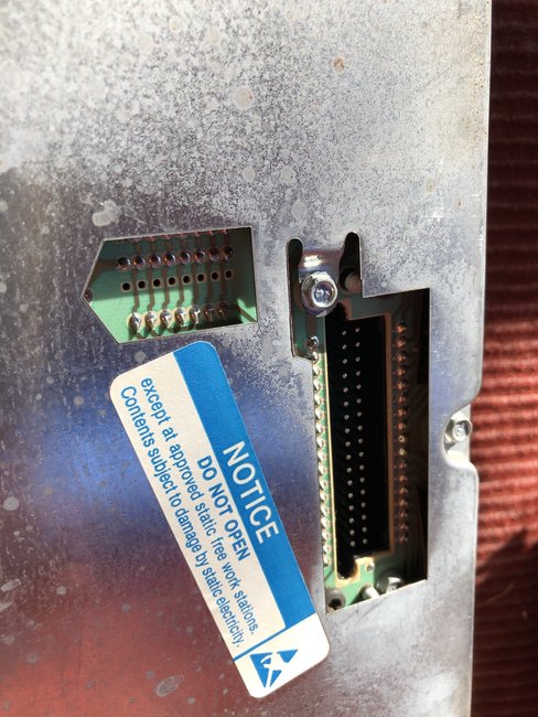

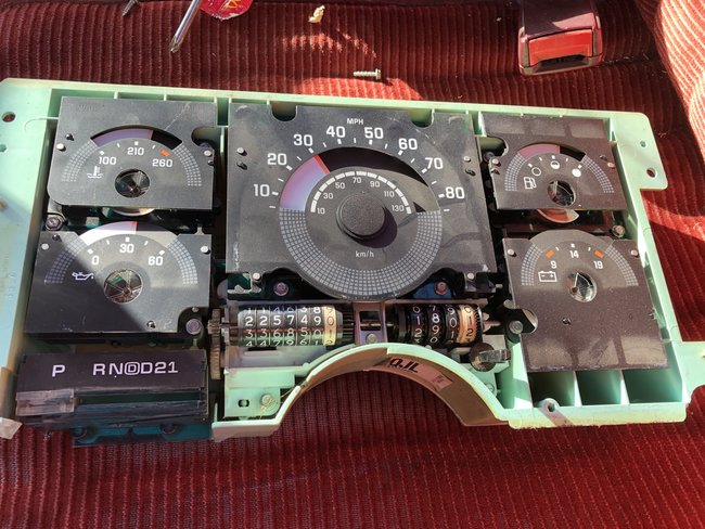

APERRADO21
  • 6 POSTS

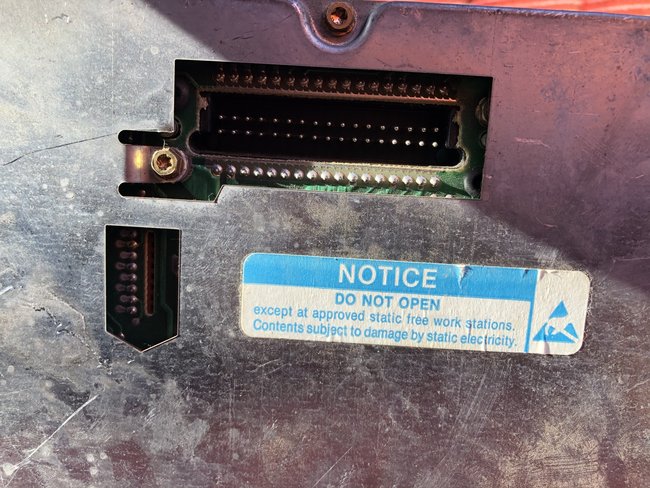

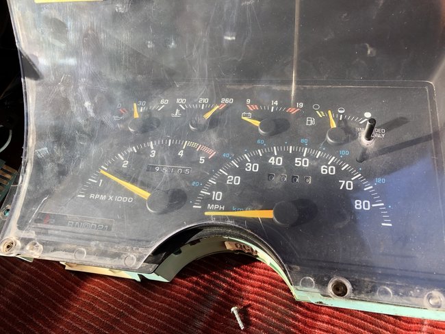

Okay, I got the rare 1991 cluster with tachometer, but when I installed it the only thing that come out is the seat belt light,do I need to move wires or make something to make the cluster work?
Jul 23, 2021 at 3:37 PM
APERRADO21
  • 6 POSTS
The first are the moonies 1990
The second the new needles with tach 1991
Jul 23, 2021 at 3:50 PM
