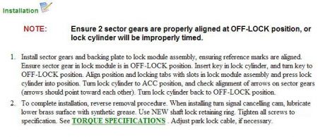

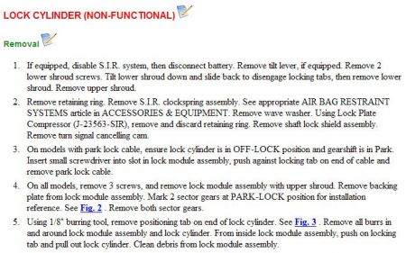

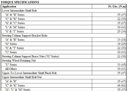

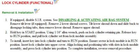

Im wandering the steps in removing and installing a ignition lock cylinder.
Feb 13, 2009 at 1:17 AM
BLUELIGHTNIN6
  • 16,542 POSTS
https://images.2carpros.com/forum/automotive_pictures/261618_Noname_237.jpg
https://images.2carpros.com/forum/automotive_pictures/261618_1_10.jpg
https://images.2carpros.com/forum/automotive_pictures/261618_2_10.jpg

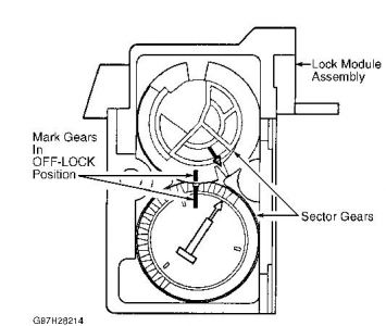

https://images.2carpros.com/forum/automotive_pictures/261618_air_1.jpg
FIGURE 2
https://images.2carpros.com/forum/automotive_pictures/261618_fig2_6.jpg

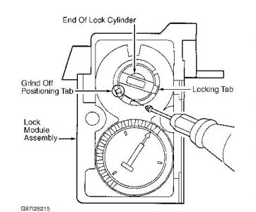

FIGURE 3
https://images.2carpros.com/forum/automotive_pictures/261618_fig3_4.jpg

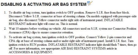

https://images.2carpros.com/forum/automotive_pictures/261618_ts_2.jpg

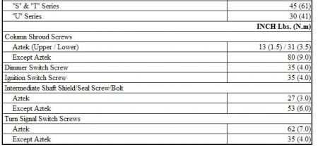

https://images.2carpros.com/forum/automotive_pictures/261618_ts2_1.jpg
