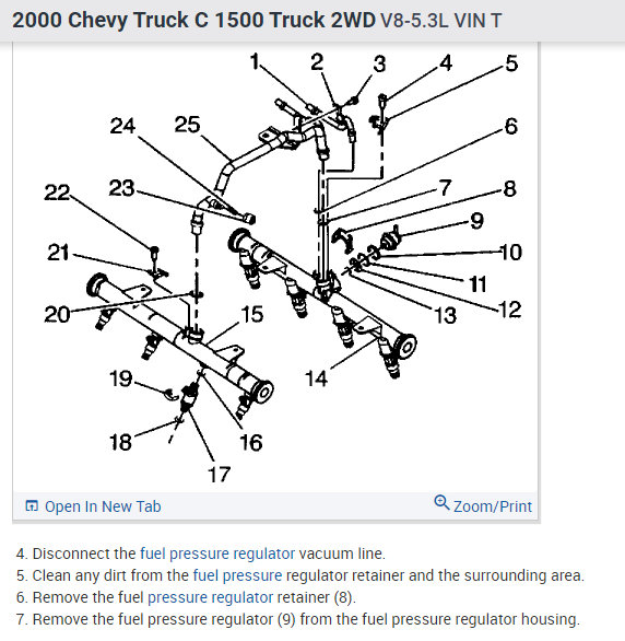

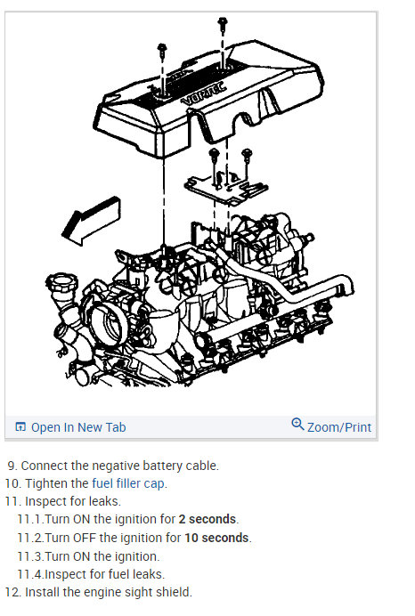

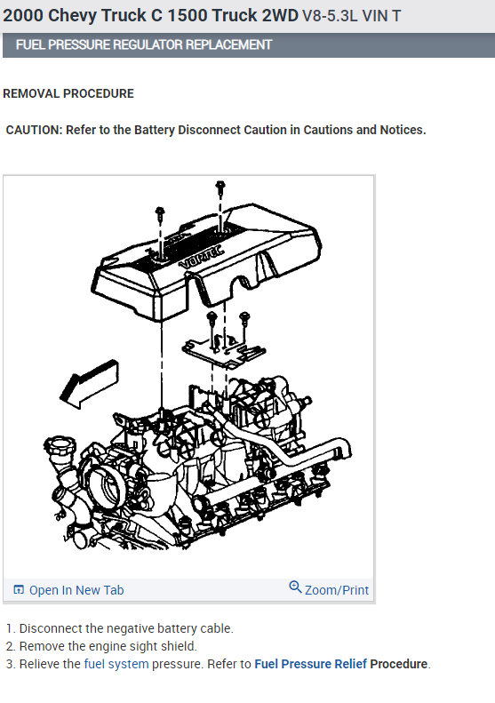

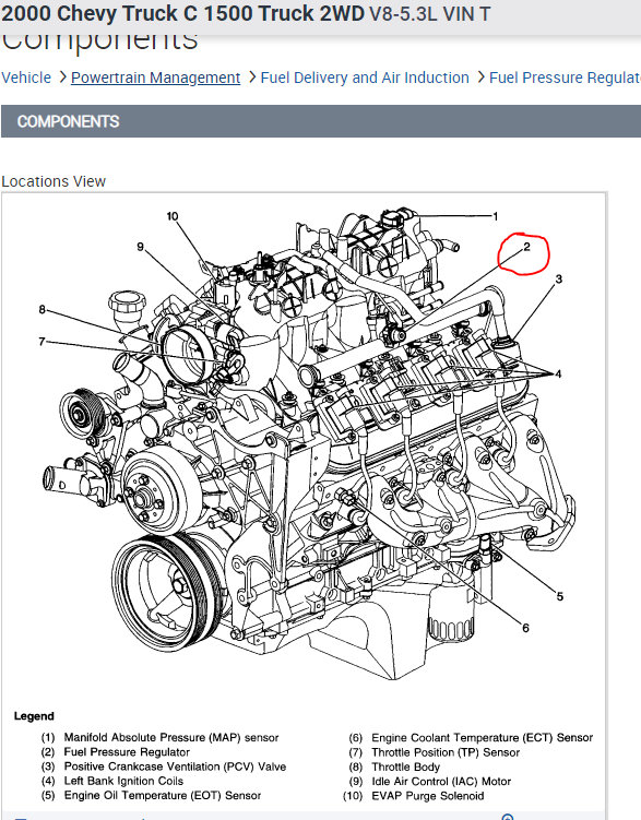

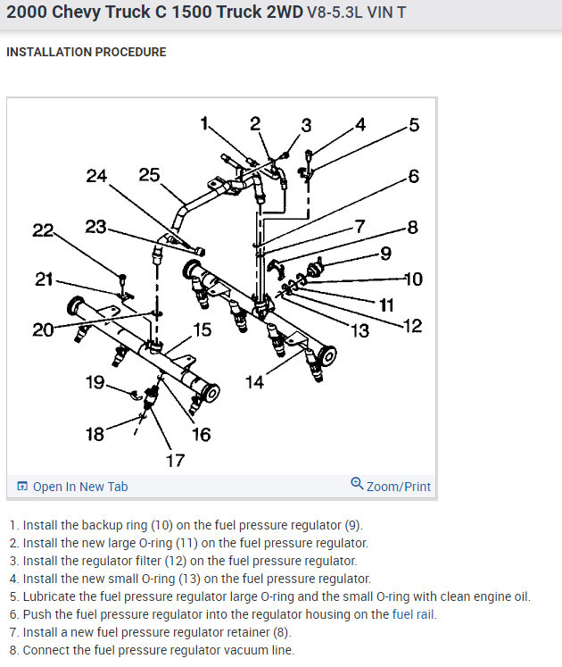

There could be a number of reasons why the engine is not staying on.
Likely not due to the ECM.
This type of issue many times due to a fuel supply issue. Like a malfunction fuel pressure regulator, or a clog in the fuel line. It can also be due to a bad mass airflow sensor or throttle position sensor.
Checking the fuel pressure could be a good place to start.
This vehicle should have 55-62 PSI of fuel pressure, with the key on and engine off.
Here is a helpful guide on how to check the fuel pressure:
