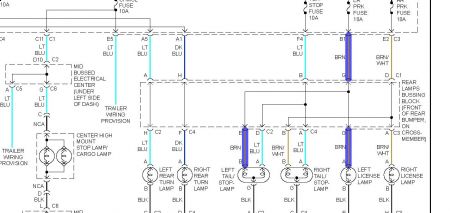

My husband and son have been trying to fix the left rear tail light and the license plate light to work. They are out of ideas. Do you have any answers?

Check the left rear park fuse 10amp could be blown located in the left side of engine compartment underhood bussed electrical center.

Checked the fuses and they are good, power at fuse on both sides but no power at the plug at the bed for the left tail light. Took the bed back off to see if wiring was pinched but all is fine. It is between fuse and rear of truck. The fuse panel is confusing at best with a fuse for every light.

Check the rear lamps bussing block in front of rear bumper on crossmember for corrossion check all brown wires to it

The bussing block at rear in front of bumper has no left tail light power at blue plug, just right tail light has power. Thats the problem I'm having, no power between fuse and blue plug going into bussing block
