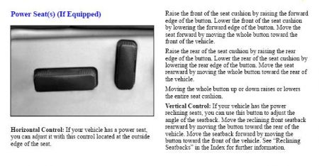

Hello. I am having an issue with my power driver's seat. I have the stated truck. The driver's side, bucket seat, powers back and forth, but not up and down (vertically). Does this mean that the seat motor needs replacing? If so, is it a difficult job to replace and where can I get the part? Thanks.

hi, Do the seat controls look like the picture? I'd have to check the wiring circuits before I could say about the motor. The switch is another possibility.
https://images.2carpros.com/forum/automotive_pictures/170934_silverado_power_seats_1.jpg

No. It only has the horizontal seat control. The horizontal seat control can be moved up and down on both the front and rear, of the control. Like I said, it works fine moving back and forth (horizontally), but when I move the control up or down, I can hear the motor, but it appears too "weak" to move the seat up/down. Hope this help. Thanks for your help.

I see, it sounds like the motor. I'd still want to check the circuits, though.

I'd remove the seat, go from there. If you can reach the motor connector without removing the seat, you can try that. For testing, you might be able to use jumper wires for voltage and ground, using inline fuse, to see if the seat will operate properly, if it does, the problem isn't the motor. If it does the same old thing, then I suspect the motor. Just to add, feel of the power seat circuit breaker, see if it feels hot, when trying to raise the seat. I believe the circuit breaker is 25 amp.

I've been checking, probably not a good idea for you to diagnose. Under the driver seat there is an airbag module, that you don't want to fool with and three motors for the seat. You might be able to look at the power switch for the seat. You still need to disarm the airbags before you do anything. I don't advise using jumper wires on anything.
