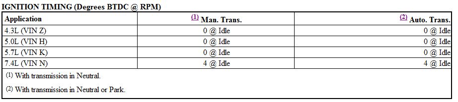

You must be talking about the EST wire-not too sure the EST applys to this year/model-am basing myself on earlier year/model such as a 92
Try looking for a tan and black connector near the distributor-this wire is for the EST ( Electronic Spark Timing ) you disconnect it then check ignition timing-once set at 0 deg the computer controls it-

I just adjusted the timing on my truck listed above it is a 5.7 liter. My truck was getting horrible gas mileage and I had already done everything else (i.E. Replaced every sensor). The timing was set at around ten degrees so I set it at zero (or about as close as I could get it to zero.) This was a pain as every time I tried to tighten that distributor bolt it adjusted the timing slightly. Anyways. When I got the bolt sufficiently tight I checked the timing one last time and then turned the truck off and reconnected the black-tan wire under the firewall (ECT or something?) I drove it around for a bit and rechecked the timing when I got back. I left the black-tan wire plugged in and noticed that my timing was way advanced (probably around sixteen degrees) and fluctuating slightly as the rpm's went up and down while idling (this is one of the annoying things I have been trying to fix). So I unplugged the wire and started to re-do the timing adjustment. Well after I unplugged that wire the timing was back to zero degrees.
So what the heck? When the wire is not plugged in the timing is at zero. When the wire is plugged in the timing reads around sixteen. Should I leave the wire unplugged? Or is it normal for the timing to jump back up when you plug the wire back in?

You disconnect the wire to reach base timing.
When the wire is connected PCM is in control of the timing and it does advance it as needed.
After base timing is set wire should be plugged back in.

1994 Chevrolet Silverado K1500, 350 v-8, automatic transmission. With timing light attached, ignition timing retards towards TDC when throttle is pressed causing engine to stumble and stall. Distributor as to be advanced so that the timing mark, at idle, is almost at the 12 o'clock position to compensate for the timing retarding when accelerating.
This results in very poor performance, fuel economy and detonation above 45 mph. I disconnected the Electronic Spark Timing wire from the distributor just to see if condition improves. Timing set around 4-6 degrees at idle with some advancing occurring when accelerator is depressed. No engine stumbling or stalling, drive performance is tolerable. However, service engine soon light remains lit, of course.
Confirmed that number 1 cylinder location on distributor is correct at TDC. Also replaced IAC and Throttle position sensors. No SES light prior to disconnecting EST wire from distributor.
I can get engine to run better with it disconnected, setting timing at 4 to 6 degrees advance at idle and it jumps to 8 to 10 degrees advanced under throttle. Once I reconnect the EST engine runs poorly as timing is retarded. That's why I had to run the distributor so far advanced with EST connected as it will retard the timing by as much as 10 degrees upon throttle.

I have seen this before it ended up being the ECM causing the issue.
Here is how the book says to set the timing.
Set parking brake, block drive wheels and place transmission in Neutral or Park.
Warm engine to normal operating temperature.
Turn A/C off (if equipped).
Ensure Malfunction Indicator Light (MIL) is not on.
Disconnect Tan/Black Electronic Spark Timing (EST) by-pass connector wire located near distributor or under the dash in the center or by the passengers side.
EST connector is located inside cab right side by heater motor, not under the hood, 1994 and up).
DO NOT disconnect 4-wire connector at distributor.
Connect timing light to No. 1 spark plug wire.
Check timing and adjust if necessary.
Reconnect EST by-pass connector, and clear ECM trouble code
Timing should be set at 0 and at idle When throttle is open timing should change as this is normal check timing chain and fuel pressure.
