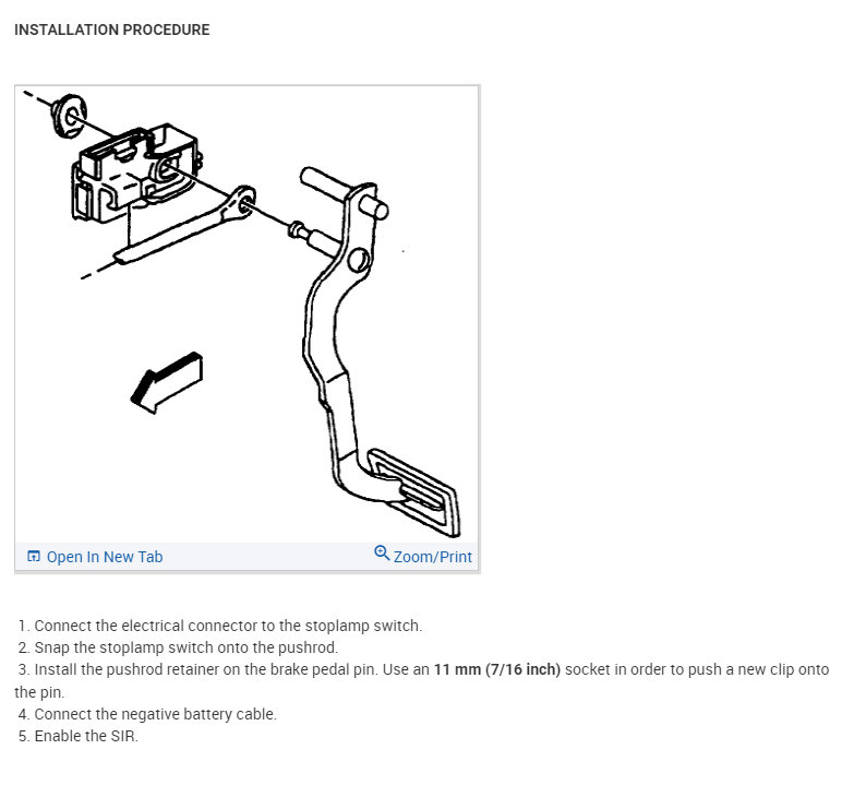

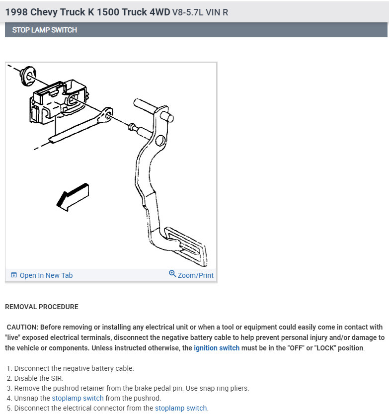

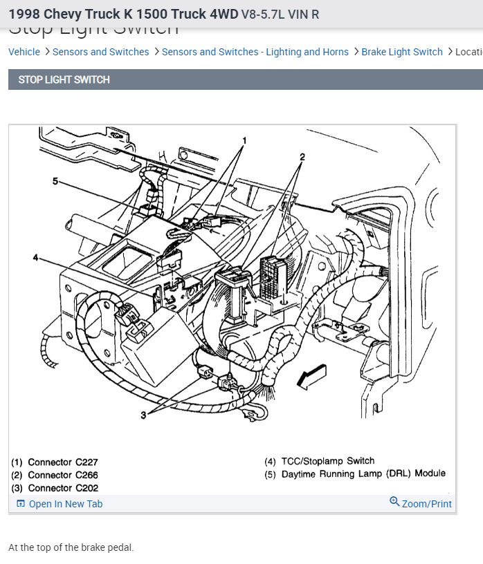

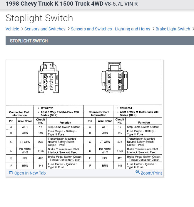

I have attached diagrams for the brake light switch replacement.
