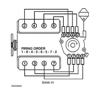

I RECENTLY replaced plugs and wires used oem parts
1 wire at a time and now i have a bit of a miss checked all the plugs for junk on them and madesure all the wries were tight it runs and acclerates ok just at a idle it stumbles or misses abit. i'm thinking a wire in the wrong place . i'm kinda new to this stuff so i would appreciate a picture of the distributer and where the wires go on the block i dont know how to find where1 cylinder is so ineed to know like drivers side rear or front drivers side type instructions my engine is a 5.7 litre any help would be usefull
