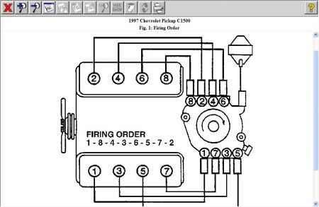

i need the diagram for distributor to correct spark plug

See below
