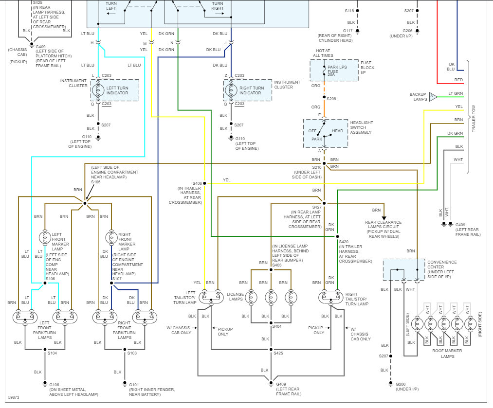

My brake lights do not work. The blinkers, reverse and tail lights all work fine. I also have a topper on the truck, which the third brake light works fine. Coming from the front of the truck are 5 wires, Brown, Yellow, Dark Green, Light Green and WHITE. The white wire has power when the brakes are applied, but the white wire is not connected to anything. I don't know where it is suppose to go. The WHITE wire is spliced into for the third brake light( which again works perfect) Anyone have the correct answer?
The bulbs are brand new, that was the first thing I tried. Both filaments work. I have ran a direct line just for a test and the bulb will do both brakes and blinker.
[img:f6a86c9029]http://www.2carpros.com/forum/automotive_pictures/263660_Lights_97_1.jpg[/img:f6a86c9029]

I have attached the wiring info for the trailer wiring. In both it states the white is a ground wire. So it should connect to the frame. I can not see from your pic, but is there a bolt, screw or something right near the wiring harness within reach of the white wire? The end of the white wire looks like it was pull out of something if I can see it correctly. I would ground it and see your results.
Also, since you have now that you have what the wires do, I would turn the lights on, the blinkers, have someone hit the brakes and test the voltage coming in to the connector before the spice and after. If there is voltage in t he wires when the tests are being done before the connector, t then the problem is after the connector. If you dont have voltage even getting to the connector, then it is farther up.

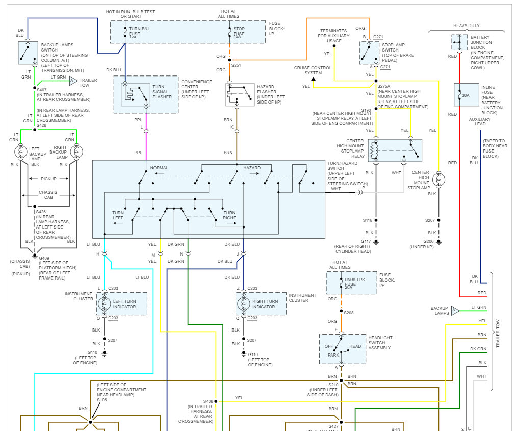

Hello - I looked back on what we have talked about and I don't see where it was said if this is a 1500, or 2500 PU. Please let me know and the exact engine and the 8th letter in the VIN. Also, the pic you attached, thanks, but the wires with the red circle around it. That is hard to see especially with the splice. Going into the plug the first is DK Green, then Lt Green, then yellow, then what - this is all the confusion area for me to see. thanks
https://images.2carpros.com/forum/automotive_pictures/248015_1_21.jpg

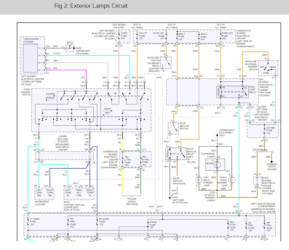

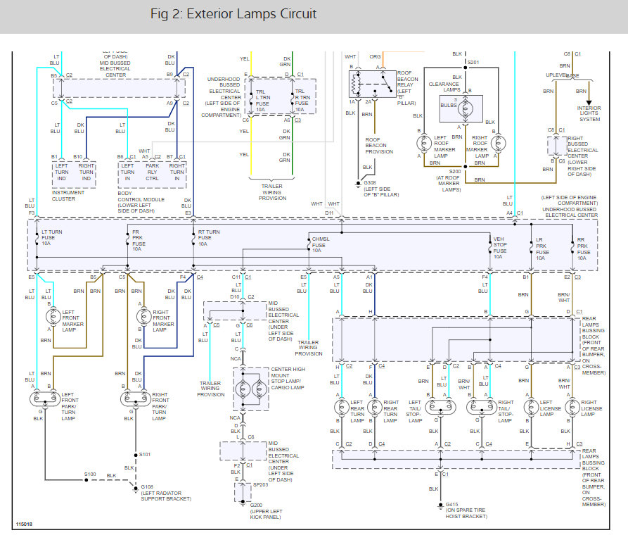

Hello - Rossickle - may I call you that? Okay - lets do a recap please to ensure you and I are on the same. I don't know about you but it helps me focus since there are numerous posts between you and I, there is time lags inbetween and, I am dealing with other vehicles. 1997 Chevy Silverado, K1500, 4WD automatic, 5.7L VIN R, 220,000 miles Based off of the above post on which towing package you have - I would say it is the UY7, heavy duty. Would you? UY1 - wire colors - - Dark blue - 30amp auxiliary circuit - Brown - Tail and license lamps - Lt Green - backup lamps - (missing from the info provided by the dealer????) - Dk Green - Right turn signal and stop lamp - Yellow - Left turn signal and stop lamp - White - ground UY7 - wire colors - - Red 30amp battery feed - Dark blue - auxiliary circuit - Brown - Tail and license lamps - Lt Green - backup lamps - Dk Green - Right turn signal and stop lamp - Yellow - Left turn signal and stop lamp - White - ground What you currently have No brake lights on rear other than on topper. DK Green and Yellow - Blinkers - okay Lt Green - Reverse - okay Brown - Tail - okay I have attached a pic for you that I drew that shows your first pic - this is the wiring harness - correct -the color of the wires and what they go too? Please let me know if this is correct. The red X on the wires mean that from what I can see, those wires are not there. Also, the from the front of the truck, I left the white wire just sitting out there, is this correct? It comes from the front of the truck with the rest and is just hanging? The second pic you sent where all you have is the harness from the front of the truck, I sent back a circled area that looked confusing. 1. The white wire that I can see no insulation on that is coming out of a blue clip: a. Is this a spliced in wire? b. If so - what color wire is it spliced into? c. Is it hot at any time? d. Did you splice it in? 2. The white wire that is coming down from the front of the vehicle, I can not tell from the pics - what is it doing or where does the go or is it just hanging? 3. In your first pic where you show the complete harness, thee is a red wire that look like it is coming out of the middle part of the harness and plugged into the blue splice. Is this correct or what is going on here? A couple of checks also When you push on the brakes - the Dark Green and Yellow wire going into the harness - do they then have 12v but when no brake nothing? With the lights on - do the Dark Green and yellow have any volts? When you have the lights on and hit the brakes - then to the dark green and yellow have 12v Also on the pic that has the red circle on it, it looks like the wires from left to right are dk green, lt green, yellow and then the next hole is empty on the connector....is that correct? Last - they system was working...you have 200+ miles. Have you recently ran over something, when did you notice they weren't working? If you can answer these questions that would be great. Let me know what ever corrections I need to make. Bob
https://images.2carpros.com/forum/automotive_pictures/248015_3_12.jpg
https://images.2carpros.com/forum/automotive_pictures/248015_2_17.jpg
https://images.2carpros.com/forum/automotive_pictures/248015_1_22.jpg
https://images.2carpros.com/forum/automotive_pictures/248015_4_6.jpg

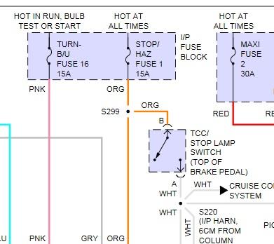

Hey one other thing.........when you turn your emergency flashers on - do the other lights act the right way ie the fronts flash etc?? If not change the hazard flasher and then check it.
https://images.2carpros.com/forum/automotive_pictures/248015_5_6.jpg

I'm posting this because no one posted the right answer yet. The most likely reason the brake lights are not working is the turn signal switch. I'm working late on the same problem and i can post more info maybe in a few days.
If the turn signals are working,check voltage coming out of brake switch. Sorry i don't have colors yet,but the wire from brake switch goes up into the steering column and feeds through the turn signal switch. The white wire coming out of harness is not the ground. I'm checking now to see what that is for. Hope that helps someone.

I have the same white wire in my harness, and after hours of studying wiring diagrams I have figured out that it is for the CHMSL (center high-mounted stop light) at the top rear of the cab. Just in case anyone else is still trying to figure it out.

check for power at the white wire at the multifunction switch when pressing the brake. if no power then trace it to the brake light switch and repair the broken wire. get back to us if you need further help
https://images.2carpros.com/forum/automotive_pictures/139033_no_3.jpg

It looks like the white wire goes to the high mount brake light relay, here are the wiring diagrams for the system so you can see how the brake light works. Also, here is a guide that might help as well:
