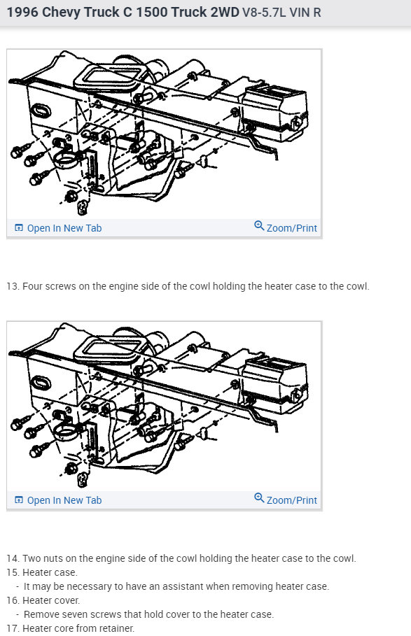

I bought the truck about 4 months ago and in the past week there is occasionally a smell coming from the A/C vents. It's similar to coolant, but I don't think it is. I've checked my coolant, and I'm not losing any. It smells like some kind of chemical though. It doesn't smell as bad if I have just the fan running. Any help would be appreciated. Thanks.

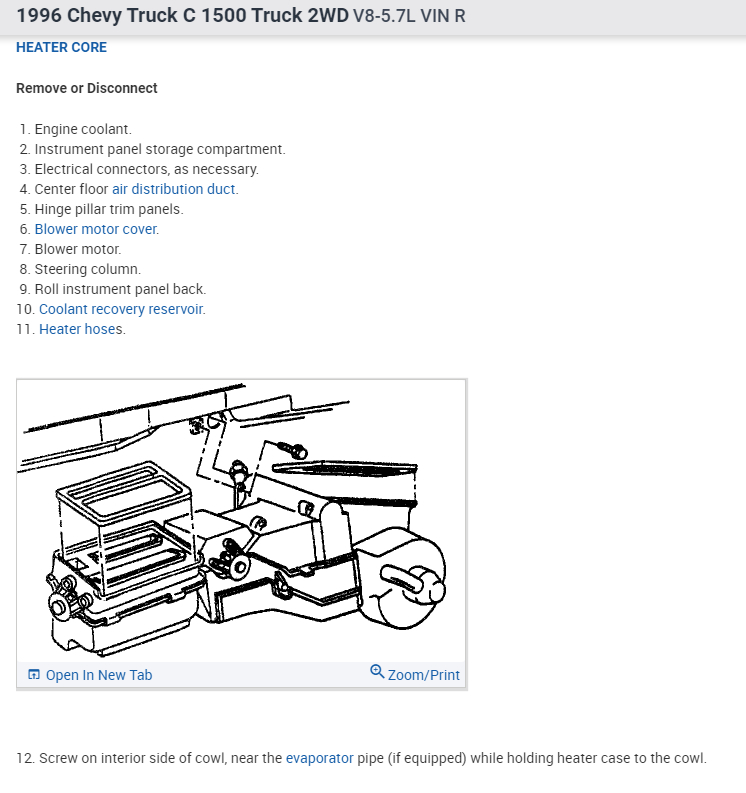

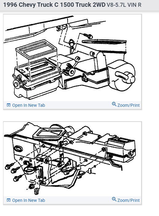

Engine coolant does have a distinct 'sweet' smell to it.
It is possible to have a small leak in the heater core that is just enough seepage to make the noise and not enough to be noticeable immediately on the coolant level.
It will be a good idea to inspect the heater core for any leaks.
https://www.2carpros.com/articles/replace-heater-core
You can also do a pressure test on the cooling system. On the pressure test the cooling system gets pressurized with a tool, and if there is a leak; the system will loose pressure and that will show up on the gauge.
Here is a helpful video showing how to do the pressure test:
https://youtu.be/W8kra65m15c
I have attached diagrams for the heater core below.
