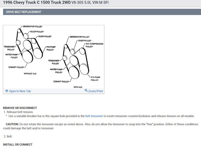

when I change the serpentine belt started slipping
1996 CHEVROLET SILVERADO
19,600 MILES • V8 • 4WD • AUTOMATIC
SAMLISSY
how come when i change the serpentine belt started slipping
Jan 21, 2009 at 3:02 PM
  • 110,244 POSTS
Hi:

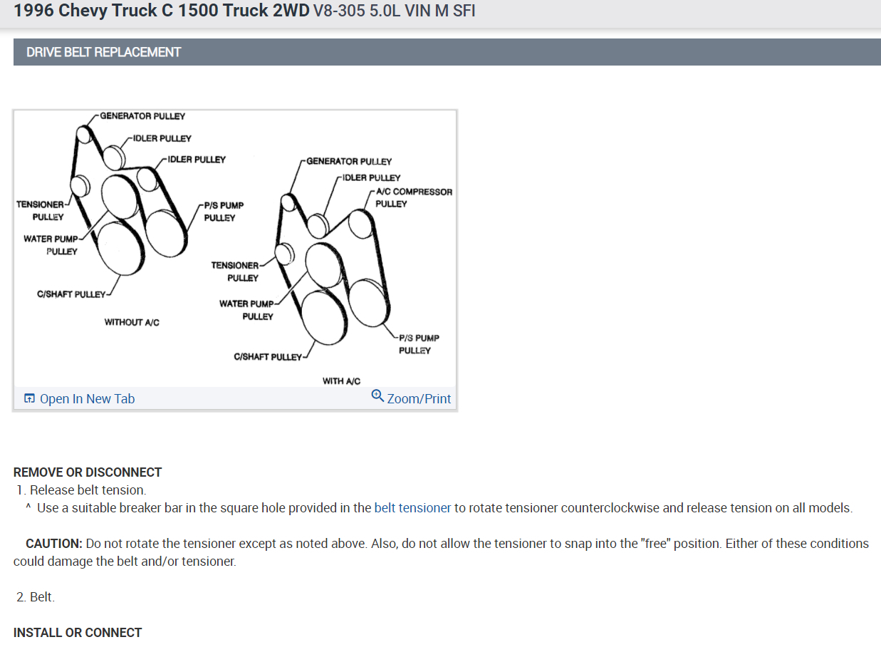

It sounds like the belt tensioner is bad, and when you removed the old one, it finally went. Check to see if the belt is tight or if it seems somewhat loose. This guide can help you change the belt out.
and
https://www.2carpros.com/diagrams/chevrolet/silverado/1999
