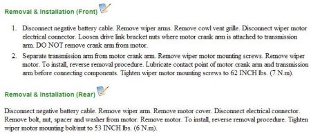

What is the procedure for replacing a wiper motor on this truck?

Jan 30, 2010 at 12:46 PM
