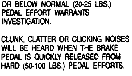

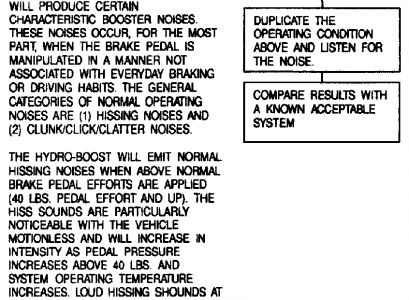

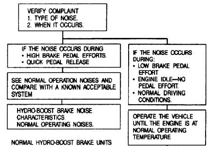

how to replace brake booster on the truck? when we step on the brakes it make a hissing sound feels like we are stepping on a pump when stepping on the brakes. the truck also pulls to the right and steering wheel is stiff. How you tell me if that is related to the brake booster?
thank you,
Feb 28, 2009 at 4:02 AM
MERLIN2021
  • 17,250 POSTS
In the case were the wheel is hard to turn, check power steering fluid level, and add if low, then turn the wheel all the way each way several times to expel air. Pulling to one side means check brake calipers and front end parts. Your power steering pump may also be no good!
https://images.2carpros.com/forum/automotive_pictures/62217_boosta_1.jpg
https://images.2carpros.com/forum/automotive_pictures/62217_boostb_1.jpg
https://images.2carpros.com/forum/automotive_pictures/62217_boostc_1.gif
