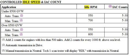

what is the idle speed for a 95 chevy 1500 engine code K

Is this what you are looking for
https://images.2carpros.com/forum/automotive_pictures/99387_s10_5.jpg
