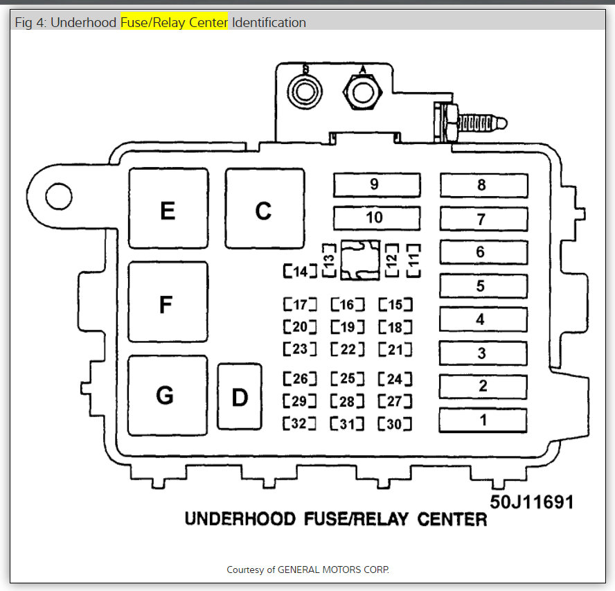

ok we have replaced complete fuel pump, distributor (all), ignition coil, ignition switch, checked fuel lines to injector, getting gas to that point then nothing can pour gas in the engine will start then stall. any help would be great thanks.

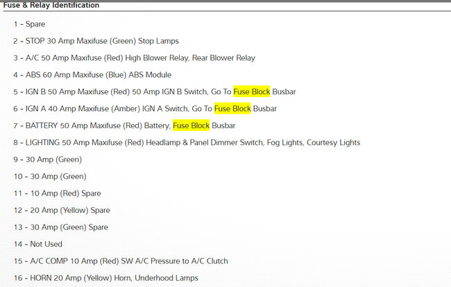

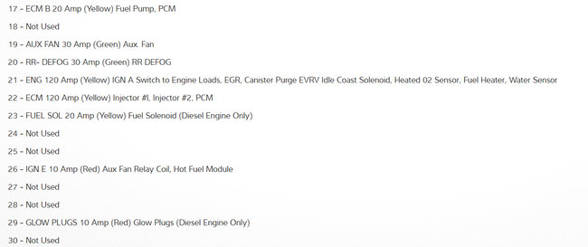

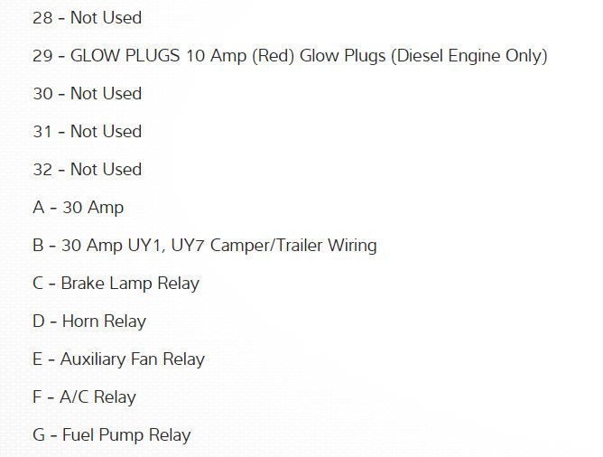

It sounds like the fuel pump relay (G) is not working here is the location so you can swap it out for a new one. Check out the diagrams (Below). Please let us know what happens.
