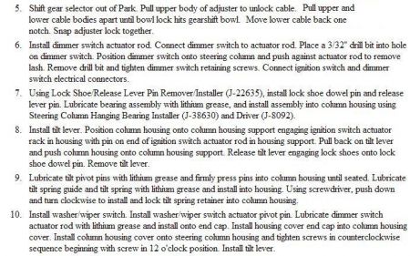

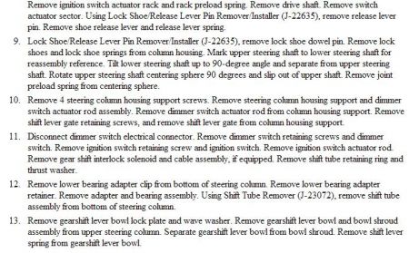

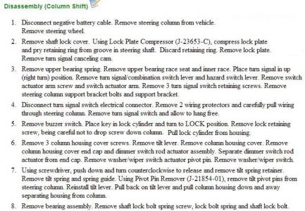

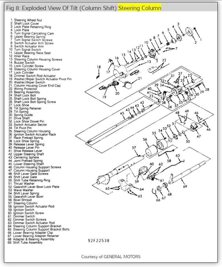

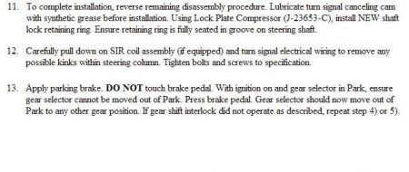

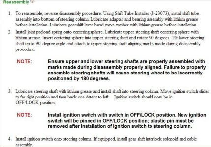

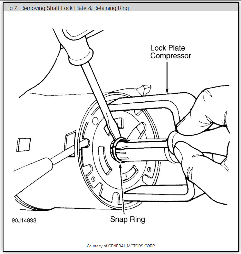

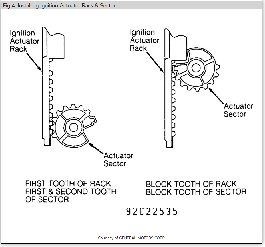

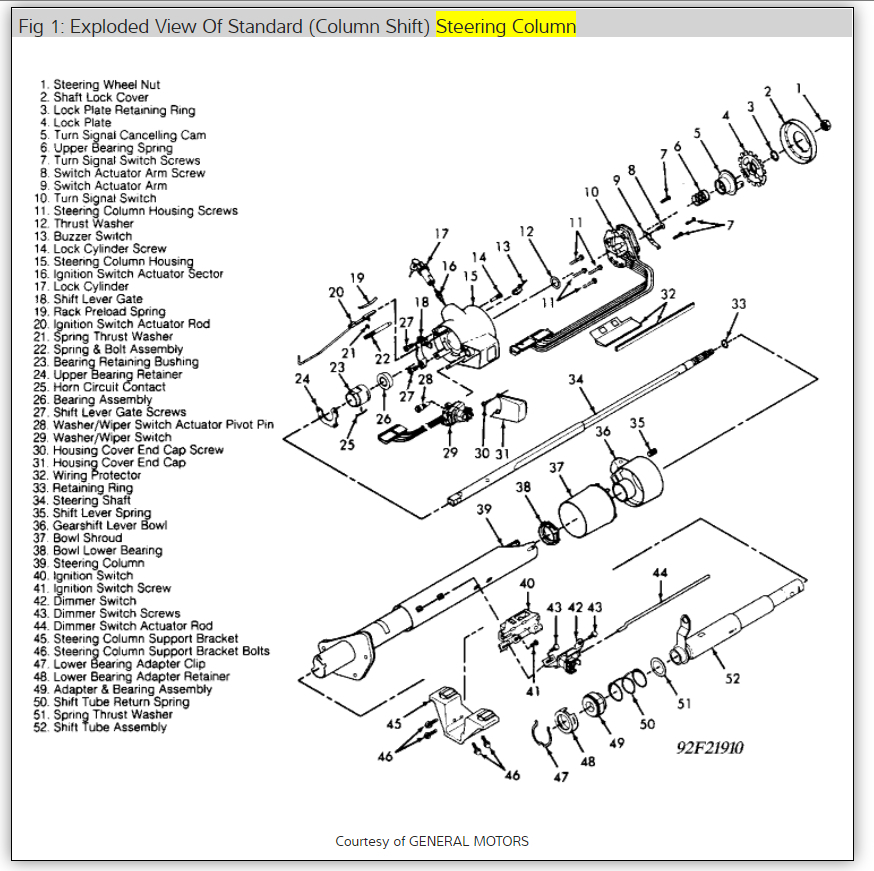

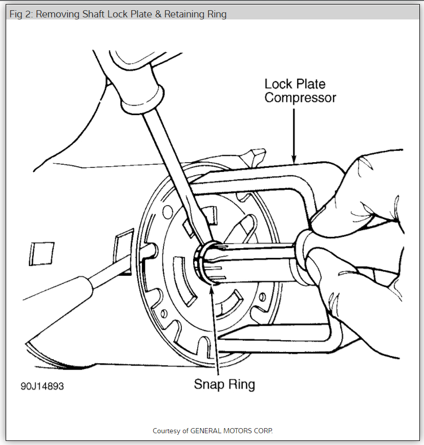

My truck's ignitiion lock locked up on me with the key in and the engine on and I am unable to turn it to the OFF position at all. Had to shut it off by disconnecting the batteries. Anyway, I have a replacement cylinder, I have pulled the steering wheel off, taken off the first ring (iff you will) that is held in place by two small screws with a torx head. Now I am stuck. I can not seem to figure out how to proceed from here. Hand an all help would be GREATLY appreciated. Thank you.
BTW - I doubt this matters but this is a 6.5 turbo diesel.

First off, is this vehicle equipped with tilt or standard steering column? Also, is it floor or column shift?

It has tilt steering with the column shift.. Thanks

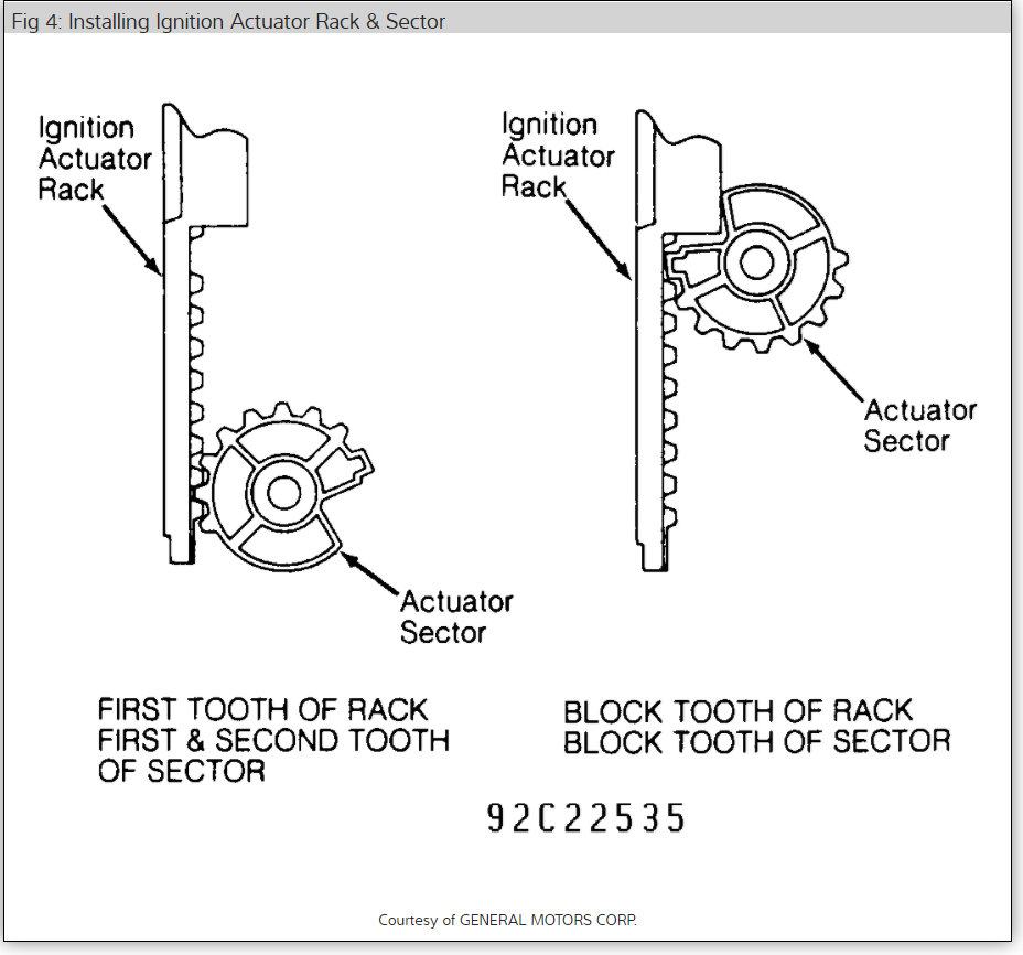

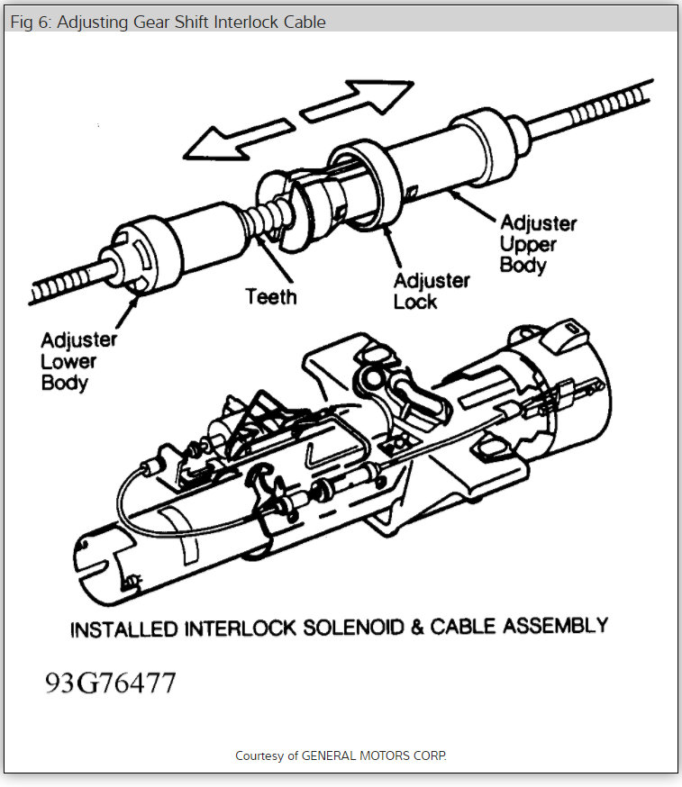

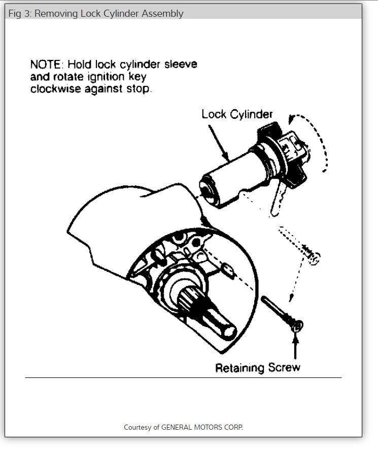

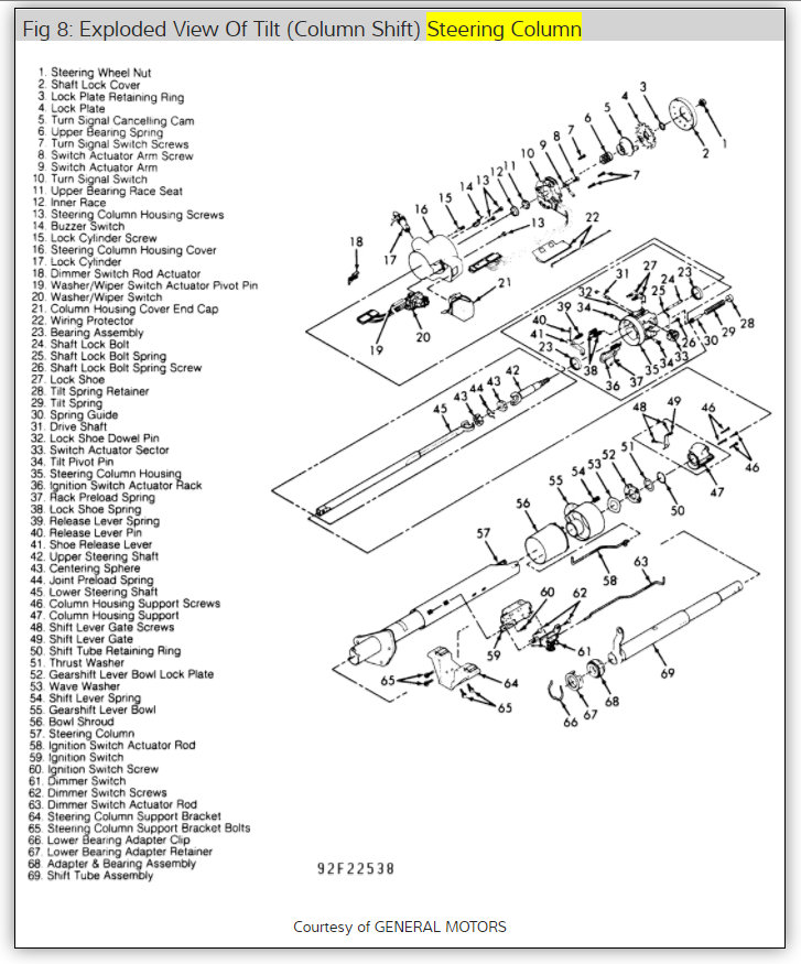

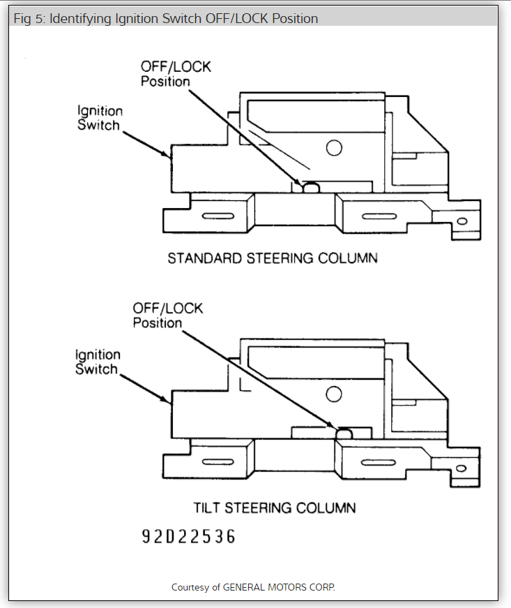

Sorry for the delay. Here is the information needed to replace your vehicle's ignition lock cylinder. Do not have to remove steering column from vehicle
https://images.2carpros.com/forum/automotive_pictures/261618_Noname_781.jpg
https://images.2carpros.com/forum/automotive_pictures/261618_Noname2_205.jpg
https://images.2carpros.com/forum/automotive_pictures/261618_Noname3_72.jpg
https://images.2carpros.com/forum/automotive_pictures/261618_Noname4_41.jpg
https://images.2carpros.com/forum/automotive_pictures/261618_Noname5_19.jpg
Aug 6, 2009 at 1:50 PM
  • 55,837 POSTS
Here are diagrams to help you see how to do the job
