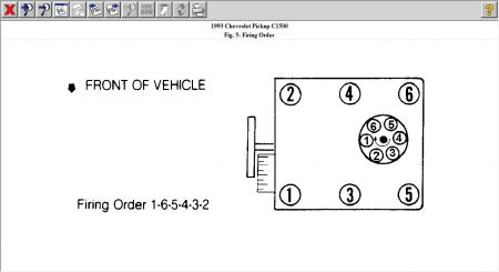

does anyone know what the firing order is on a 93 chevy v6 pick-up eith a 4.3l engine, I also need to know the positions on the distributor cap?
Sunday, August 9th, 2020 AT 12:20 PM (Merged)

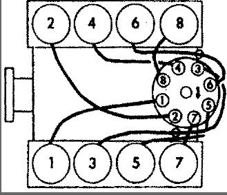

I was checking spark plug wires and found one lose, I don't know if firing order is correct. Can you send a diagram of firing order on chevy 350?
+1
DCS1998
MEMBER
41 POSTS
1-8-4-3-6-5-7-2.

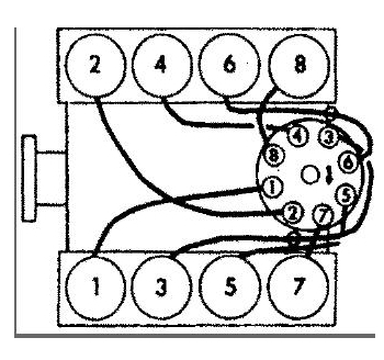

DANNY L
MECHANIC
5,648 POSTS
Hello, I'm Danny.
Here is the information you requested. I've attached a picture below of the firing and cylinder order. Hope this helps and thanks for using 2CarPros.
Image (Click to make bigger)
+5
Saturday, March 6th, 2021 AT 4:52 PM

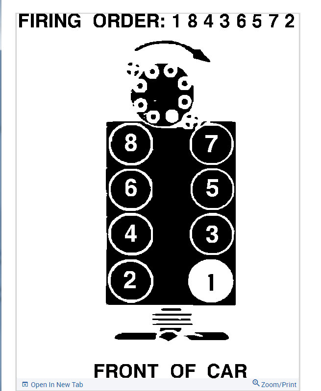

MECHANIC
18,907 POSTS
Take a look at the attachment below for the detail on the firing order and positioning of the cylinders and distributor.
Let me know if you have questions. Thanks
+1
Saturday, March 6th, 2021 AT 4:54 PM
