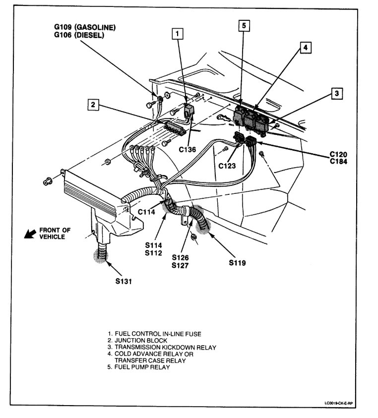

Pulled tank and tested fuel pump by hooking sending unit straight to battery works fine. Will not work when it is plugged into regular wires. Traced wires did not see any breaks or bad spots. Replaced relay and fuel pump fuse. Also the ignition was replaced about 4 months ago. It died a couple of days ago and I checked to see if it was getting fuel but wasnt sprayed starting fluid in th throttle body and it would star but die of course. I also checked the pump before I pulled tank by runnig a wire from battery to the aldl g wire and nothing happened the book said pump was bad. Please help dont know what else to do!

So no fuel sprays from the injectors when its turning over. Do you hear the electric pump turning for approx. 3 seconds when you turn on the key? Reason I ask is the problem may be fuel pump related or fuel injector related. Trying to isolate your problem. Reading your issue again, it sounds like the pump isnt working, but I would need verification of my initial question. If the pump is not turning on, you could get a test light and find the fuel pump relay which is located on the firewall behind a black plastic cover on the passenger side under the hood. Find the gray wire and backprobe it while someone turns on the key. This wire goes directly to the fuel pump.
Here is a guide to help check the fuse and the relay with the location of the fuse and relay in the diagrams below.
and
Check out the diagrams (Below). Please run this test and get back to us.

There is no power going to fuel pump through harness relay is new could the oil pressure switch be the problem, or maybe even ecm? I was told that it may be a wire from the battery or maybe even the starter is this true? I need to get this thing on the road to soon. Please help

Check the wiring near the pump. Check the connectors between wiring harness and pump. Check for bad grounds.

Check the fuel pump connector-it should come on for 2 secs when the fuel pump relay is activated-if not check the relay-

Check out the fuel pump oil pressure switch, if it fails then fuel pump will not get power. It is found on teh rear of the engine block near the distributor (4.3L, 5.0L & 5.7L) OR on the left side of engine block under the exhaust manifold (7.4L).

If the fuel pump relay is good then check the computer controlled of the fuel pump relay circuit, computer might not be grounding the relay if the fuel pump is not being activated-the oil pressure switch powers the pump after the engine starts
