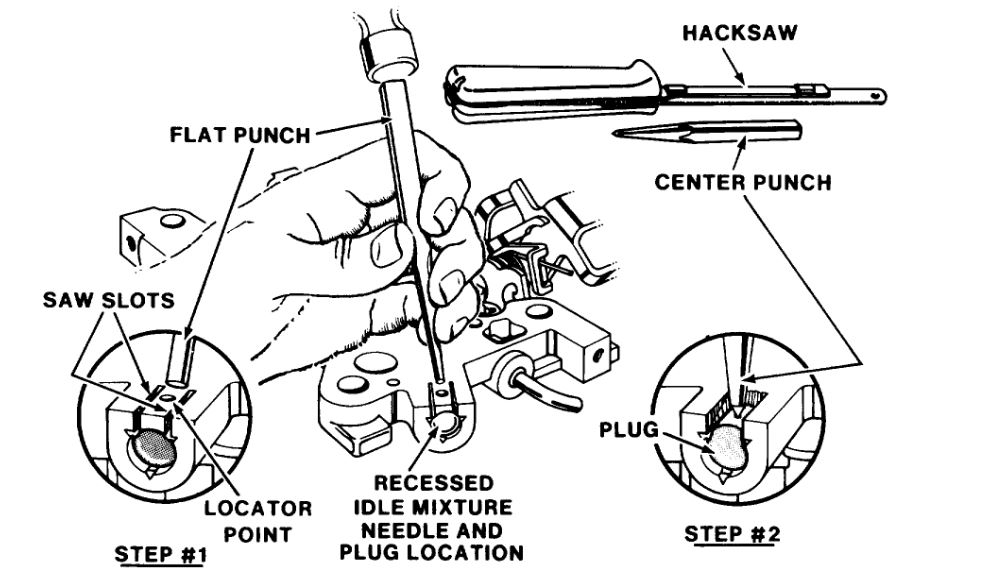

Overheated and now will not stay running unless your foot is on the accelerator.
Thursday, September 3rd, 2020 AT 1:07 PM (Merged)
  • 52,797 POSTS
Good evening.
Did you resolve the overheating issue?
https://www.2carpros.com/articles/engine-overheating-or-running-hot
The idle is controlled by the carburetor. It has its own idle circuit. There are 2 screws on the bottom front of the carburetor to adjust the air into the engine.
Did you check for any vacuum leaks?
