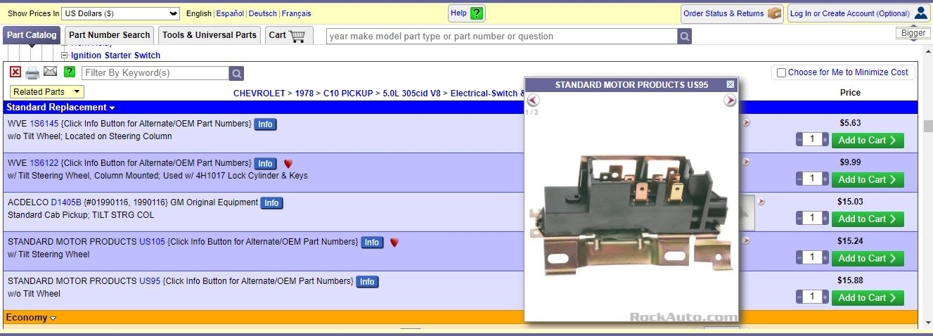

Good morning,
The switch is at the bottom of the steering column. It has two screws that secure it to the column. The switch for the high beams is attached to it as well. You need to remove the high beam switch first and then the bolts for the ignition switch are right there.
It should take you about 30 minutes.
