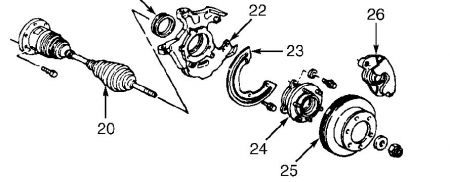

I have a 2000 s10 4wd with manual trans and 4.3 v6
it has 74000 miles my question is how hard are the front wheel bearings to replace and are they pressed in or can i get them out with a hammer. i have good mechanical skills i just want a heads up before i jump in head first thank you for any help

Its wheel bearing and hub assembly Axle nut is a problem if you don’t have the means to loosen it Safely jack and support the truck Remove tire Loosen axle nut Remove the caliper Brakes Brake rotor Remove 3 holding bolts Remove hub assembly If w/ABS disconnect sensor Good luck Be safe
https://images.2carpros.com/forum/automotive_pictures/99387_s10_1.jpg
