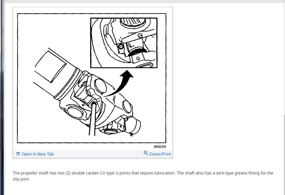

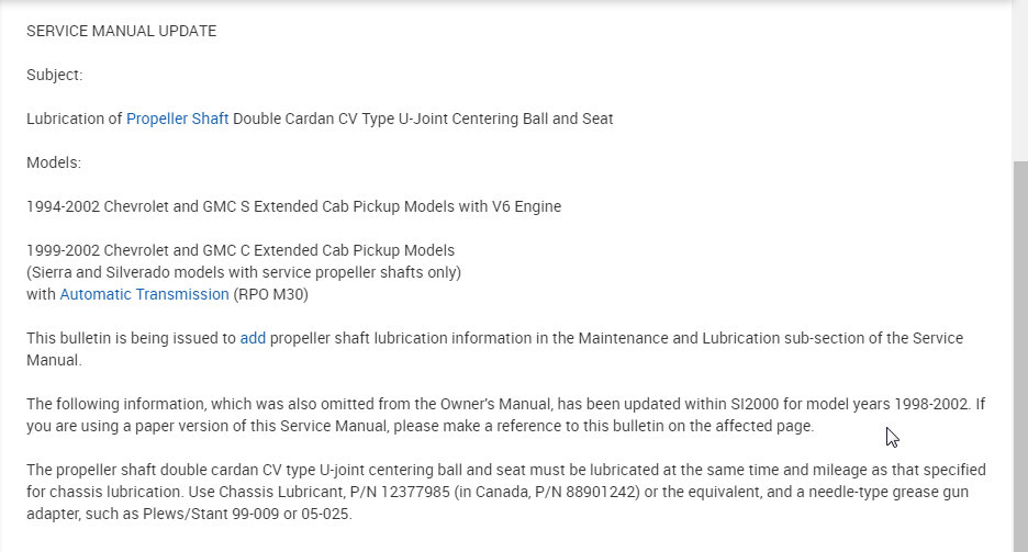

This is a two piece drive shaft and it has what is called a double cardan joint. They require lubrication from a specialized lubrication tool. Basically it is a smaller nipple and requires lubrication or it will fail and cause the vibration that you are feeling. This is common on any truck with these double cardan joints because most shops don''t have the tool so they just skip it.
I attached a TSB that talks in more detail about this. I understand that you replaced u joints but this is most likely the cause.
Please reach out with questions and we can go from there. Thanks
