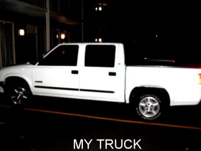

I have a 2002 chevy S-10,4x4,crew cab p/u, 92,500 miles, 4.3L...
The air conditioner suddanly stop working, everything comes on, except the compressor, but it blows hot air,,,have checked the fuses, all ok...just recently replaced the S belt...don't know what else to check...Help ?
[img:37d0f23b50]http://www.2carpros.com/forum/automotive_pictures/65902_my_truck_1.jpg[/img:37d0f23b50]
