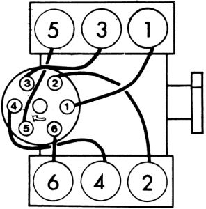

here is the firing order now do you mean you heard a loud bang and the valve cover came off?
