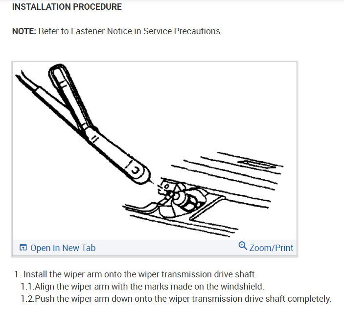

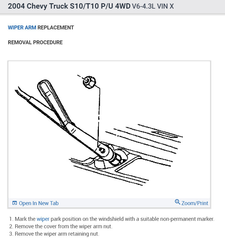

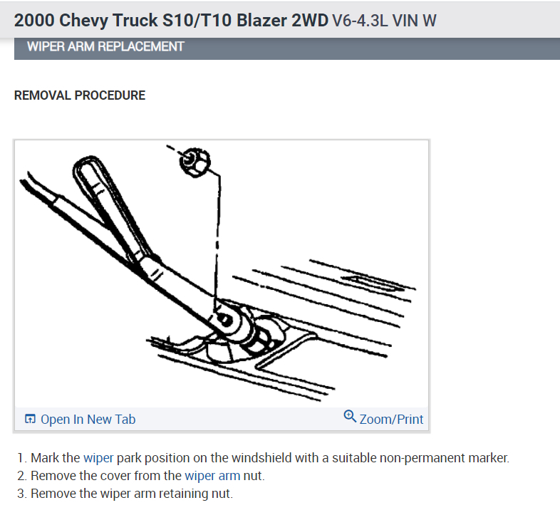

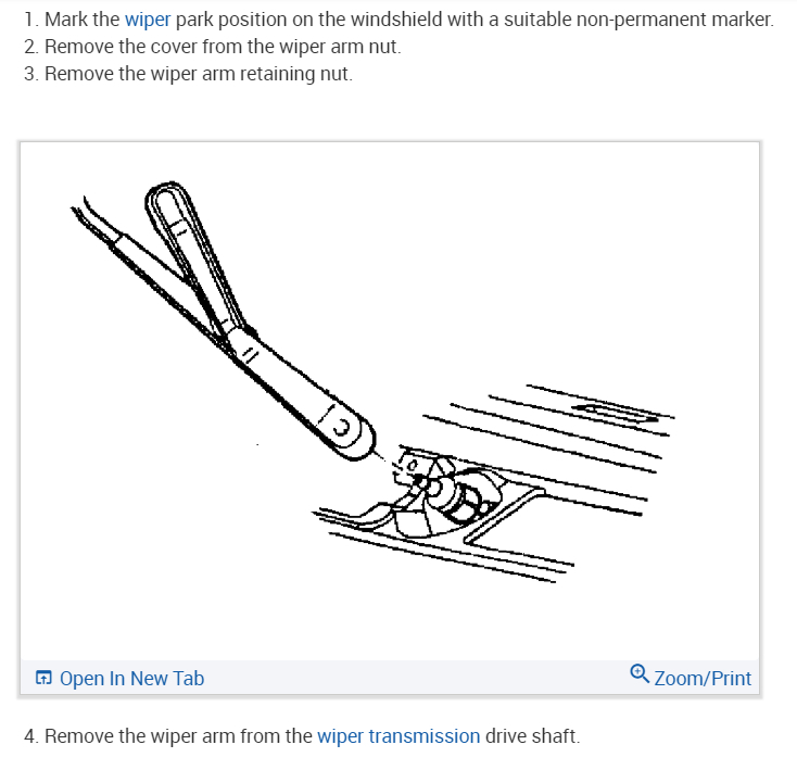

Here is the instructions and diagrams to help you change the wiper arm out. I would apply pressure then shock it with a hammer. Check out the diagrams (Below). Please let us know if you need anything else to get the problem fixed.

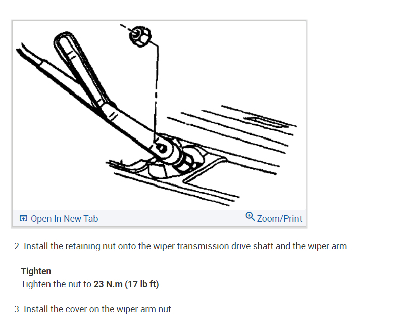

When you say "wiper arm" I take it the windshield wiper arm attachment to the wiper transmission the spline where the wiper arm attaches to area is loose. The wiper arm needs to be clocked 90 degrees then fully depressed onto the wiper transmission. When the arm is fully engaged to wiper knop it should click and fold down to the vertical position. If wiper arm has a nut under a cover on the wiper arm simply tighten it if your in proper alignment. Check out the diagrams (Below). Please let us know if you need anything else to get the problem fixed.

The whole end is the cover, under it there wil be a nut. Sounds like the arm broke the pivot bushing, no big deal to fix

if it doesn't have a bolt or nut holding it on there may be a little lock that will come loose. If not that then it will just pull off but that is better done with a tool to take it off or a flat screwdriver to help pry it off.

pull the arms up then look at the base of the arm there is a little hole that goes straight through. put a nail in it or cotter pin. then let pressure off of arm and wiggle it, it should pop off. hope this helps

There are two ways they can be secured. One is by a bolt under a cover where the wiper arm is attached. The other has a slide clip that is at the base of the arm. Is will slid open and then the arm can come off.
