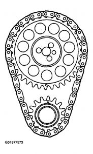

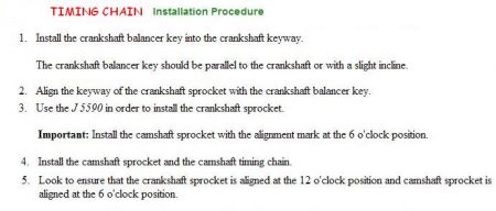

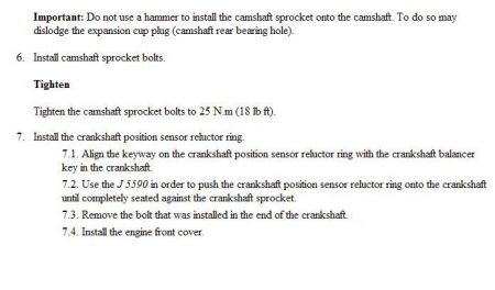

2003 Chevy S-10 4 cyl Two Wheel Drive Automatic
How to reset the timing on a s10 chevy 4.3
