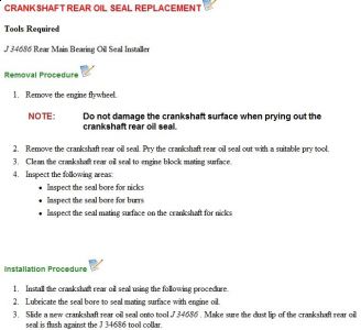

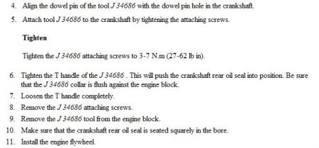

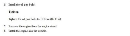

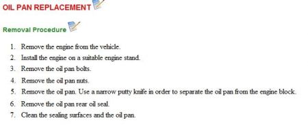

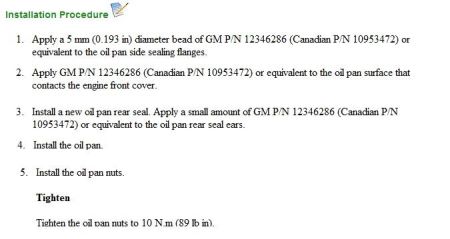

how to replace the oil pan gasket and rear main seal thanks "franky"
Mar 18, 2010 at 10:19 PM
BLUELIGHTNIN6
  • 16,542 POSTS
hello and thanks for donating below are the proper steps to replacing your vehicle's oil pan gasket and rear main seal..if you need further assistance with these repairs feel free to ask me a follow up question
