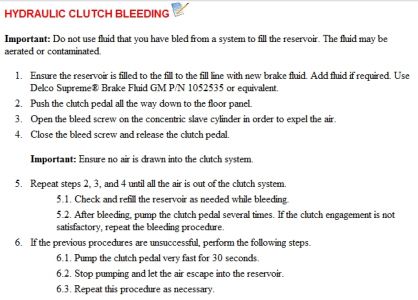

ive replaced the clutch master cylinder and all i need to know is how to bleed it? it started workin until i went a ways down the road and started not working again, im told that i didnt bleed it right.

https://images.2carpros.com/forum/automotive_pictures/261618_Noname_2099.jpg
