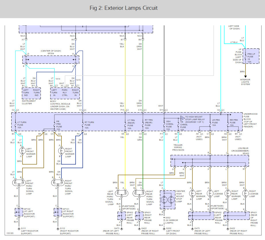

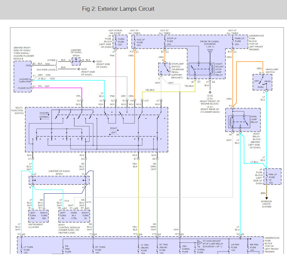

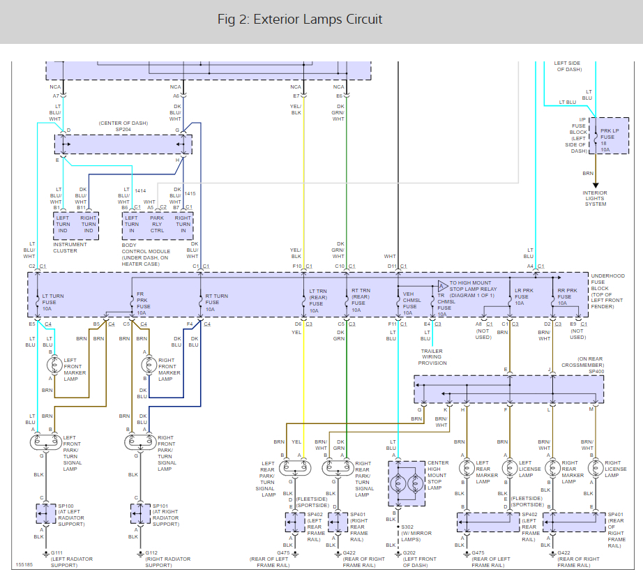

I'm trying to find trailer light wire hook up location to add trailer light socket.
Apr 8, 2008 at 11:18 AM
2CARPRO JACK
  • 11,533 POSTS
Some trucks dont come with trailer wiring option you must wiring it yourself here is the wiring diagrams so you can do so. If your has one it will be tapes behind the rear bumper.
Cheers
