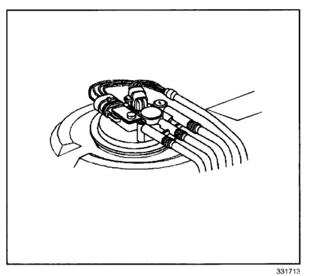

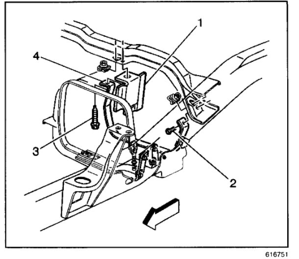

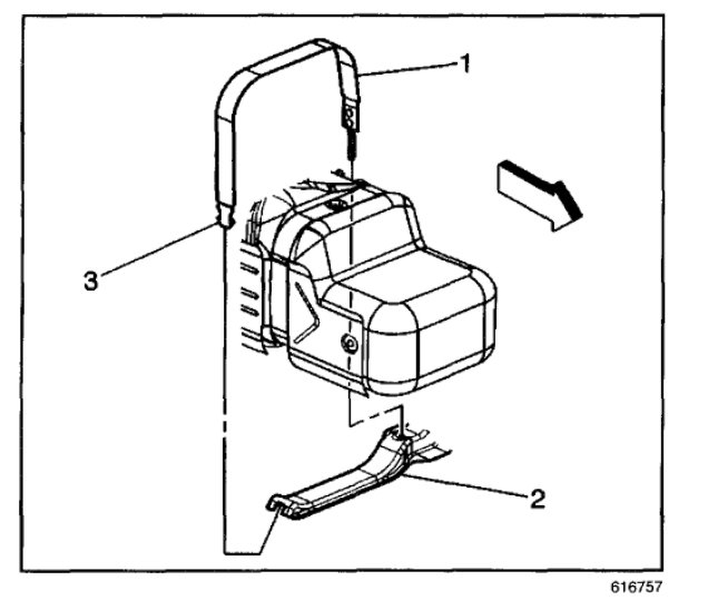

To remove the tank you have to relieve pressure then drain fuel. Raise and support vehicle and support fuel tank. Remove straps from tank and lower down some, then remove wiring and fuel lines from tank.

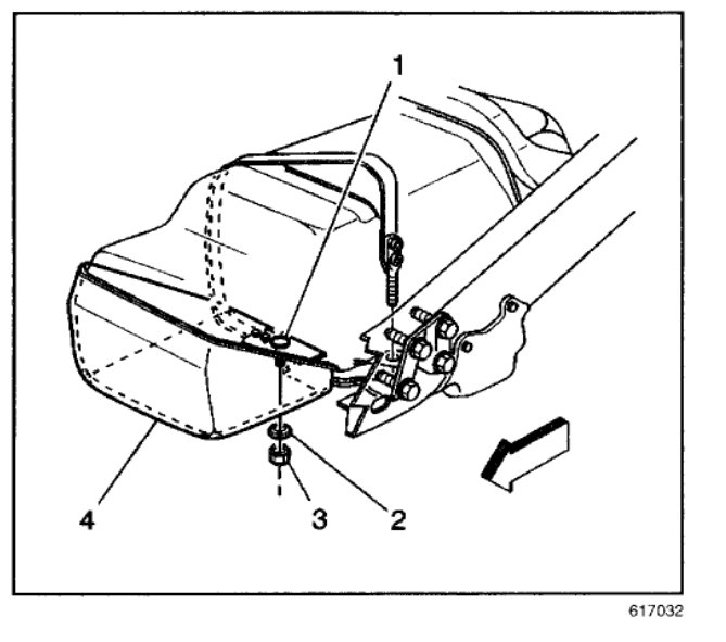

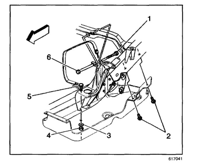

Tighten the fuel tank shield bolts (2) to 11 N.m (97 lb in) .
Tighten the fuel tank shield nut (4) to 25 N.m (18 lb ft) .
Install the fuel tank shield to crossmember bolts (1) and nuts (6).
Tighten the fuel tank shield bolts and nuts to 23 N.m (17 lb ft) .

I have a 2002 S10 crew cab PU. I am trying to remove the fuel tank. The Claymers manual shows two straps holding it but mine seems to have a piece with 4 bolts holding it under the tank.Almost seems like the drive shaft needs to come out and the tank should slide out to the side. Any thoughts?
Nov 26, 2017 at 1:08 PM (Merged)
SWILLIAMS
  • 597 POSTS
Sounds like your vehicle has the optional skid plates on it. Those 4 bolts should come out using a torx bit and some luck. Then you will find the 2 straps that hold the tank in place. When you get the skid plate off you will probably want to grab a cheap die and chase the threads on the bolts that hold the strap. They tend to rust and then the bolts can break off. Not fun.

The tank is held in by 2 straps plus the electrical plug and lines going in.
You might find that it's easier to lift the bed off than pull the tank. That's what I do.
Remove the 4 bolts from the driver's side and loosen the ones on the right side. Remove the screws from the filler and you can tilt the bed toward the passenger side. Just make sure it is supported well before getting under it.

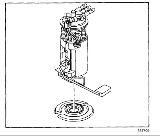

Replacing the fuel pump, which is in the tank. How to drop the tank is the question.

It's been a while since worked under an S10 but I believe there is a shield protecting the tank itself, which will have about 6 bolts holding it.
If not then there are 2 straps hold the tank up, and only 2 bolts. If you are using a floor jack I suggest you get a piece of plywood at least 14" x 14" to distribute the wieght of the tank. You will also need to remove the bolts inside the gas fill that is holding the fill tube.
After that slowly lower the tank till you can get to the eletrical and fuel connections to disconnect.
Once disconnected lower tank to ground and replace pump.
