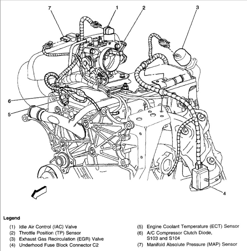

Hello Some of these engines did not have an EGR in 2002 but if it did it would be in the diagram below. The 4.3L engine's EGR valve is located on the top, front of the engine. EGR valve is pictured below.. If you need replacement procedures just let me know..

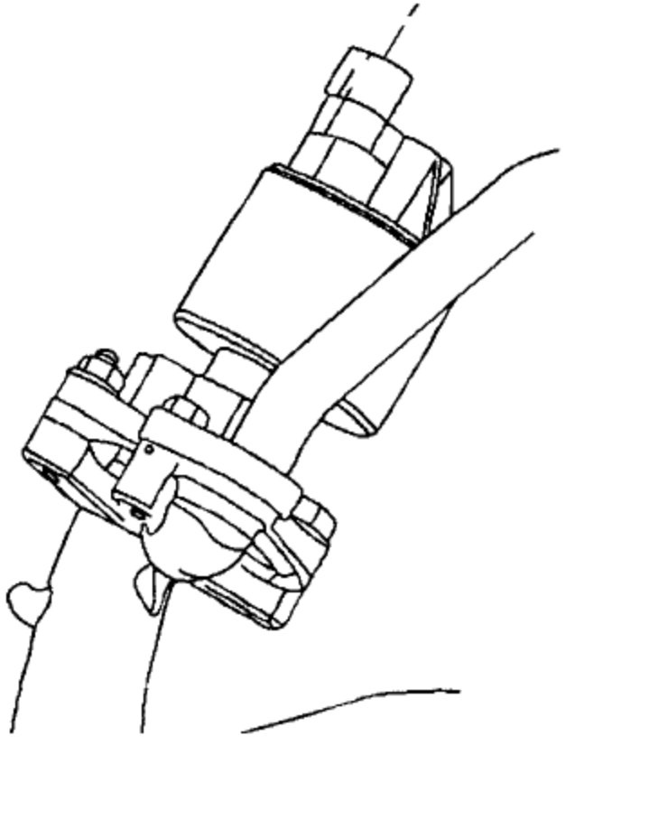

My EGR valve that I bought looks like the one below. My codes have not come up for it yet but after replacing the plugs, wires, cap, and coil I did research and found that the EGR can get stuck open and make the truck run like it has an oversized cam (which it does and gets about 10 MPG) so i just got the Valve and Gasket.
https://www.2carpros.com/images/question_images/199261/original.jpg
Feb 12, 2009 at 5:59 PM
BLUELIGHTNIN6
  • 16,542 POSTS
Sorry about that, the one I posted was just a basic egr valve shown. Your picture is the correct one for your vehicle.

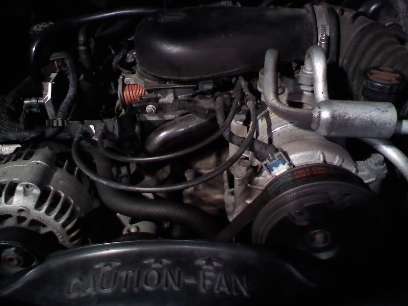

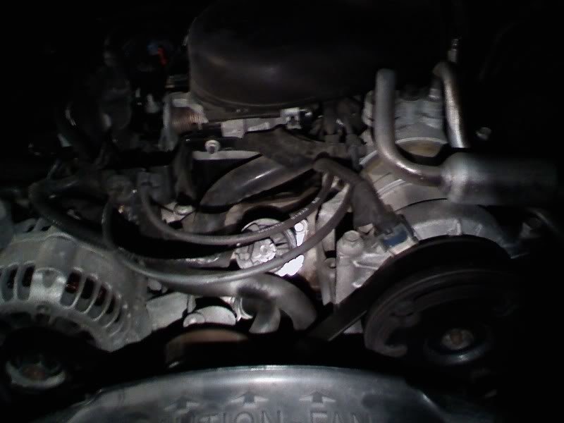

I have a pic of the 2000 compared to the 2002: 2000 (missing EGR)
https://www.2carpros.com/images/question_images/199262/original.jpg
2002 (With EGR)
https://www.2carpros.com/images/question_images/199263/original.jpg
- Notice the EGR off the the right of the alternator (its kind of shiny in the 2002 pic but its not in the same spot on the 2000.

Yes, but I meant a pic of your actual engine so I can see what the area looks like where the EGR should be.
Feb 12, 2009 at 6:39 PM
GOOCH1548
  • 7 POSTS
so your asking for a picture of the whole engine bay to try to see if you would know where the EGR valve is? (correct?) because the valve should be in the blank spot in the 2000 pic.
Feb 12, 2009 at 6:43 PM
BLUELIGHTNIN6
  • 16,542 POSTS
Okay, I am confused now..
Your vehicle you have listed is a 2002 model.. You have the 2002 pictured WITH the EGR valve?.. You are saying that the 2000 model is the one without the valve now...? Clear me up a little please? I will trace the vacuum hose from intake to the valve in vacuum diagrams once I know which model it is.
Feb 12, 2009 at 6:46 PM
GOOCH1548
  • 7 POSTS
I'm sorry that was my fault. The top pic is my truck that I need to fix the EGR and its the 2002. The bottom one is the truck that has the same engine but has the EGR is plain site right where the diagram and sent had it located.... so the top one is the one that has the problem. sorry i get confused too.
Good luck I traced hoses and wiring all night haha.
Feb 12, 2009 at 6:49 PM
BLUELIGHTNIN6
  • 16,542 POSTS
Isn't that a bolt hole behind the hose in the pic same place as 2000 model? Looks like it is just gone?
Feb 12, 2009 at 7:02 PM
GOOCH1548
  • 7 POSTS
there is one on the mount below the top pully but nothing in the shape on the valve... wouldn"t there be two hole to mount the valve and two for the valve to do its thing.
Feb 12, 2009 at 7:10 PM
BLUELIGHTNIN6
  • 16,542 POSTS
Oh okay, sorry hard to tell from the pic. You may need to call the dealer and give them your VIN to see if they can tell you where it is at because all of my sources list it in the same spot, sorry. I do know that not all vehicles are equipped with the EGR valve but I would think that the S-10 would have one .

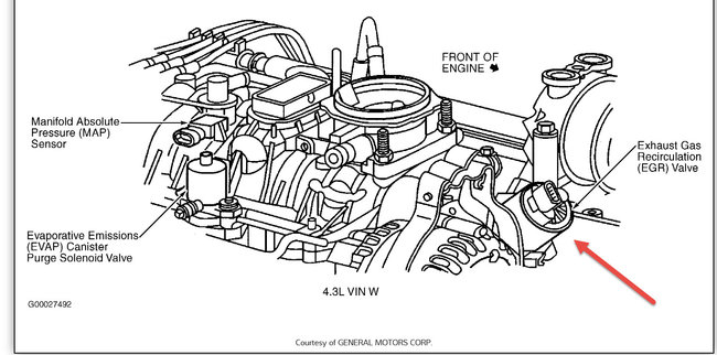

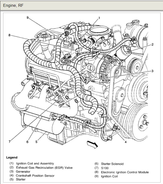

  • 55,579 POSTS
The EGR valve is located at the rear of the engine on the 4 cylinder and at the front of the engine for the 6 cylinder.
Here is a video on how to test the EGR valve check it out.
https://youtu.be/DqUCbbKdWf4
Here are the location diagrams (below).
