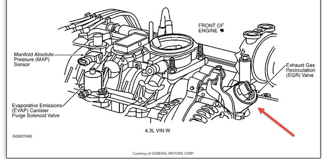

I have to change my EGR valve on my S10 4x4 4.3L Vortec FI and I cannot locate the EGR Valve for the life of me. I found it on my other S10 that is 2 years younger but I can't find it on the 2002... Can you help at all???
Feb 12, 2009 at 4:45 PM
BLUELIGHTNIN6
  • 16,542 POSTS

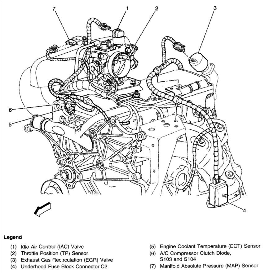

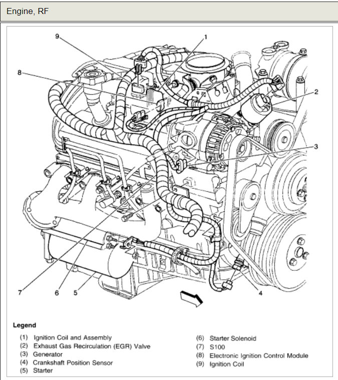

Hello Some of these engines did not have an EGR in 2002 but if it did it would be in the diagram below. The 4.3L engine's EGR valve is located on the top, front of the engine. EGR valve is pictured below.. If you need replacement procedures just let me know..

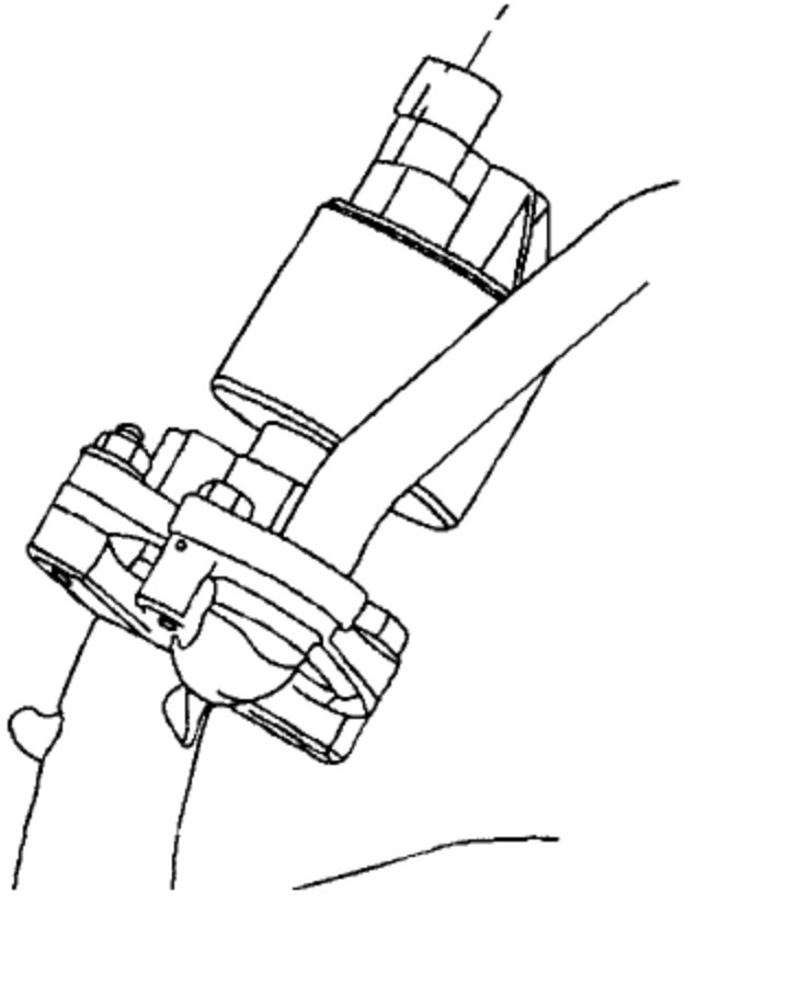

My EGR valve that I bought looks like the one below. My codes have not come up for it yet but after replacing the plugs, wires, cap, and coil I did research and found that the EGR can get stuck open and make the truck run like it has an oversized cam (which it does and gets about 10 MPG) so i just got the Valve and Gasket.

Sorry about that, the one I posted was just a basic egr valve shown. Your picture is the correct one for your vehicle.
Without being able to see your engine I really can't help you locate it if it isn't where it should be. Perhaps a call to your local Chevrolet dealer may be able to help as to where it will be if it isn't on the top front of the engine as it should be.

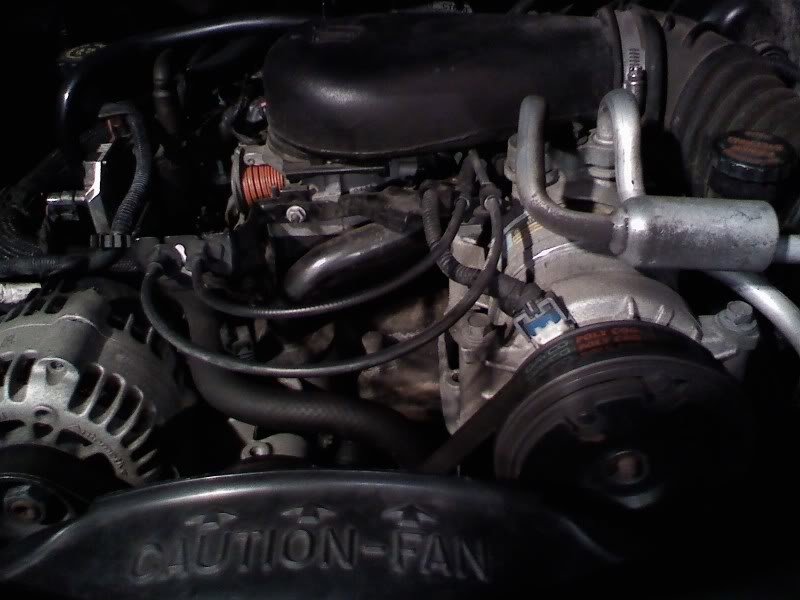

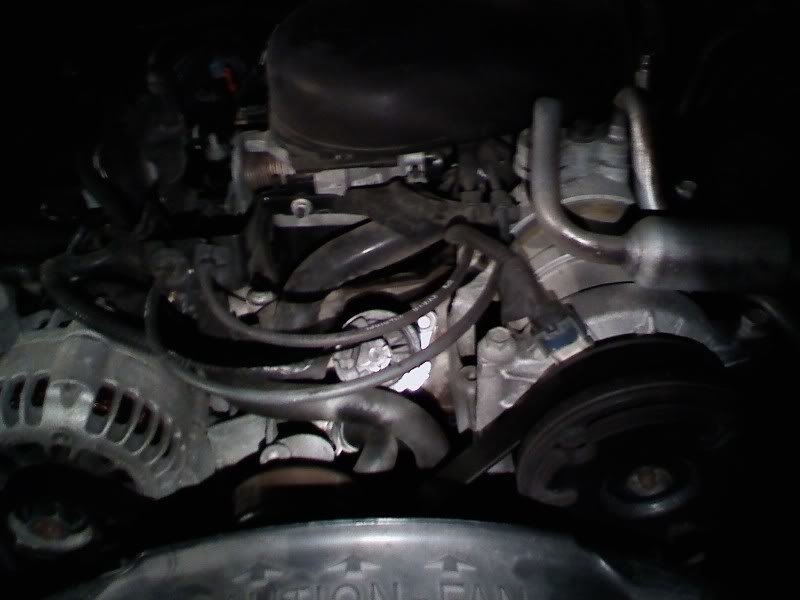

I have a pic of the 2000 compared to the 2002: 2000 (missing EGR)
https://www.2carpros.com/images/question_images/199262/original.jpg
2002 (With EGR)
https://www.2carpros.com/images/question_images/199263/original.jpg
- Notice the EGR off the the right of the alternator (its kind of shiny in the 2002 pic but its not in the same spot on the 2000.

so your asking for a picture of the whole engine bay to try to see if you would know where the EGR valve is? (correct?) because the valve should be in the blank spot in the 2000 pic.

Your vehicle you have listed is a 2002 model.. You have the 2002 pictured WITH the EGR valve?.. You are saying that the 2000 model is the one without the valve now...? Clear me up a little please? I will trace the vacuum hose from intake to the valve in vacuum diagrams once I know which model it is.

I'm sorry that was my fault. The top pic is my truck that I need to fix the EGR and its the 2002. The bottom one is the truck that has the same engine but has the EGR is plain site right where the diagram and sent had it located.... so the top one is the one that has the problem. sorry i get confused too.

Isn't that a bolt hole behind the hose in the pic same place as 2000 model? Looks like it is just gone?

there is one on the mount below the top pully but nothing in the shape on the valve... wouldn"t there be two hole to mount the valve and two for the valve to do its thing.

Oh okay, sorry hard to tell from the pic. You may need to call the dealer and give them your VIN to see if they can tell you where it is at because all of my sources list it in the same spot, sorry. I do know that not all vehicles are equipped with the EGR valve but I would think that the S-10 would have one .

Check the 8th digit of your vehicle vin
if it is an X you have no egr valve, anything after 1998
may or may not have egr.
even some of the W engines 1999 and newer also
had no egr, my guess is you have no egr.

SOUND HOUND
Some do not have one!. Starting in 02, emissions were clean enough to not need EGR. I know I have one 02 Blazer S 10,4.3L that has no EGR valve. I had a trouble code and someone told me it was for egr, bought one, and after 4 shops couldn't find it, another told me about this (no wonder we couldn't find it, NOT THERE)

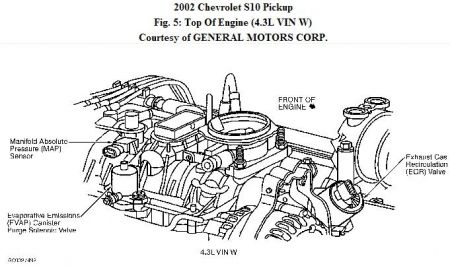

The EGR valve is located at the rear of the engine on the 4 cylinder and at the front of the engine for the 6 cylinder.
Here is a video on how to test the EGR valve check it out.
https://youtu.be/DqUCbbKdWf4
Here are the location diagrams (below).
