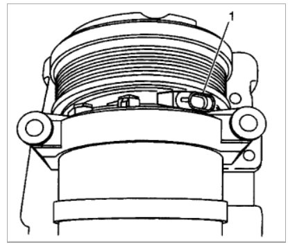

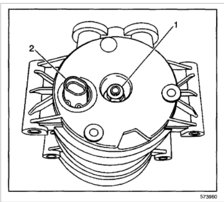

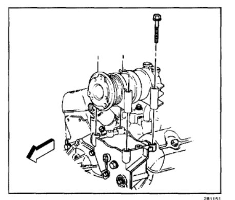

Air Conditioning problem 4 cyl Two Wheel Drive Manual 85000 miles
I just refilled my ac unit with r134. it still is blowing hot air. I took it to my buddy's shop and we cleaned all the lines out and changed the orphus tube. We put everything back together and refilled it. The high side is only reading 100 on the gauge. The compressor is working but the cold air it is not getting circulated through the system and is still blowing hot air. What next?
Jun 22, 2010 at 10:20 AM
  • 55,423 POSTS
It sounds like you have a compressor that has gone out becasue the seals are worn out. Here is a guide to show you how to change the compressor out and vacuum down and recharge the system.
https://www.2carpros.com/articles/replace-air-conditioner-compressor
and
This guide may help as well.
Here is a belt diagram page for you too.
https://www.2carpros.com/diagrams/chevrolet/s10-pickup/2002
Tighten the bolts to 50 N.m (37 lb ft) .
Tighten the nut to 12 N.m (106 lb in) .
(Check out the diagrams below)

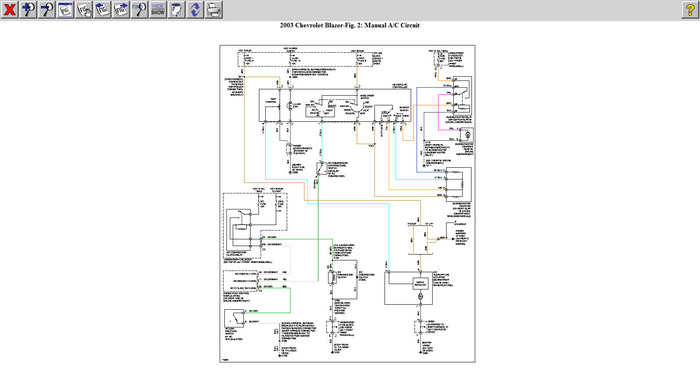

I am trying to hunt the failure to blow hot air and would like to be able to see the gm schematic of the parts layout of the heat/coolac system.
I can't find parts scematic for spit.
Help
Thanks
Nov 20, 2017 at 7:15 AM (Merged)
HMAC300
  • 48,601 POSTS
if it's not blowing on high, it can be a relay, if not on the lower speeds then it 's probably the resistor. the resistor is by the blower motor. but i'll send your schematic.
