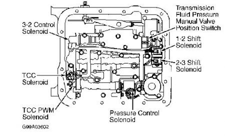

Now that the codes can be read, here is what it says.
" a short to ground or a short to battery has been detected in shift selonoid A". The problem I am having is the car will not shift into overdrive or lock up the converter. When you are under the car looking up at the tranny, is selonoid A on the Pass or drivers side in the tranny?
Thanks in advance.
Aug 28, 2008 at 12:51 PM
MASTERTECHTIM
  • 4,750 POSTS
https://images.2carpros.com/forum/automotive_pictures/139033_no_12.jpg
Aug 28, 2008 at 2:10 PM
BADBO
  • 35 POSTS
Change 1-2 and 2-3 they are the same and come in pairs at any gm dealer. If you like you may use a DOMV and check the resistance on each one. You meter should show all 000's if it is good.

PROCESSOR2008
Thanks again for your prompt reply and excellent help. Right on the money, again!!
