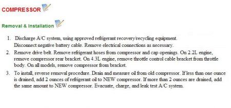

i think i have a bad bering in my compressor. how do i change the part my self? i cannot afford the part and the labor, how much do you think it would cost to have it changed(labor)

The compressor is the expensive part here, not the labor. If you can afford the compressor than you should go ahead and pay for labor because it requires special tools for this repair..
https://images.2carpros.com/forum/automotive_pictures/261618_Noname_1263.jpg
https://images.2carpros.com/forum/automotive_pictures/261618_Noname2_373.jpg
