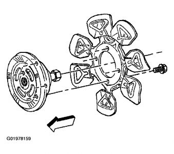

how to remove fan clutch that is not attached to the waterpump, and is held by 1 large nut. I am unable to restrain the nut with belt

Have to use 2 fan clutch wrenches to remove the fan and clutch assembly then remove the fan from clutch, its normal threads (left to loosen).

Where do you use second fanclutch wrench

Can also go another way, you have 4 bolts that hold the fan and pulley bell to the water pump and in the center of all that, you have a big inch and a quarter hex that holds the clutch fan. Remove 2 of the 4 bolts. Replace them with 2 and a half inch bolts the same thread. Hold a pry bar between the 2 long bolts and crank the hex off
