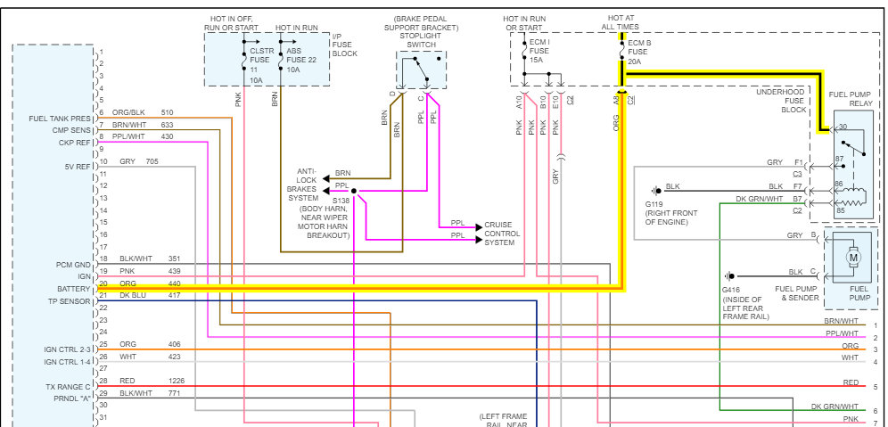

i have a 2001 chevy s10 and it was running good.then all of sudden it died out.i found out that one of ecm fuses (20amp) keeps blowing out as soon as i turn the key towards on.is there any way you could guide me in the right way towards fixing my problem.

This is likely due to a short in the wiring. Check the wire for short to ground. Look for any melted part or exposes insulation.
Here is a helpful guide on how to check wiring:
I have attached the wiring schematics for your reference.
