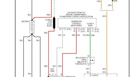

My alternator seem to be shutting off (voltage meter drops to around 12-13 volts), but if I floor it for a few seconds while driving, it kicks back in. Could this be my serpentine belt slipping or is it unfortunately my alternator?
Friday, June 20th, 2008 AT 8:02 PM
  • 75,992 POSTS
Could be slipping bcuz the tensioner is acting up or the computer controlled field generation of the alternator
https://www.2carpros.com/forum/automotive_pictures/12900_field_2.jpg
