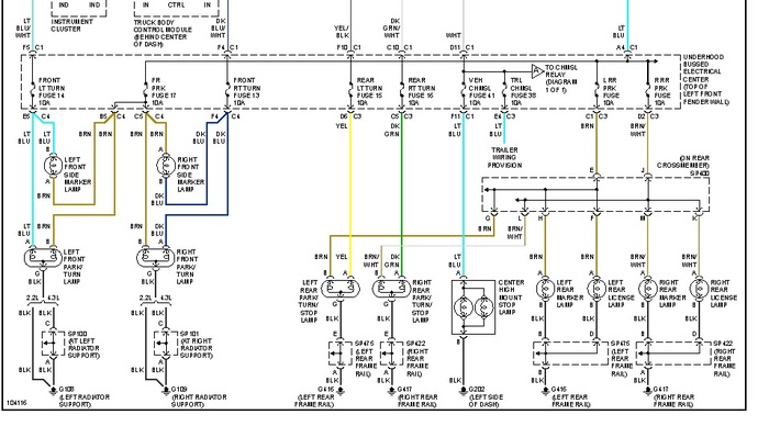

My right turn signal started to flash rapidly when I turn it on. I checked the bulbs and replaced (even though they did not appear to be bad), still flashes rapidly. I had a trail wiring harness so I disconnected it, still does not work. There was a plug that attached the wires from the truck to the rear lights, which is where the trailer harness was attached, I removed it thinking that it might be the problem and it still does not work. I checked the bare wires from the truck with a tester and I can get the tail lights to work when I turn on my head lights and I can get the left turn signal to work but not the righ turn signal. I followed the wire conduit to the front of the truck and I did not see any areas that looked pinched or damaged. I then lose it when it gets to the front of the truck.

check the ground on both front and rear of truck on right rear of frame rail and right radiator support for right side and same are opposite for left side. If those are ok then have it scanned for codes as it may be a body module problem.

Did you check for voltage and ground at the circuit in question. Your lower brake lites are wired through the multifunction switch. In the diagram check the turn fuses for voltage, key on, turn signal on. If no voltage that will take us back to multifunctions switch.
Your lower brake lites and turn signal use the same bulb fillament, just not at the same time.

I had a similar issue, I put a meter on the fuse box with the turn signal on left then right, voltage was all over the place, I cleaned up the grounds near the blinkers on the radiator core support, then I replaced the wire and fuse going from the battery to a 175amp little fuse then to the fuse box, this solved my issue except for the right blinker, it flashes fine but fast like front and both work fine they just flash fast had a running light out on the right rear as well, just a funny set of symptoms, this may be your issue, sorry for being 4 years late, just wanted to add my experience. Could be your issue, I'm going to put a meter on my sockets to double check. Thank you for your time.
