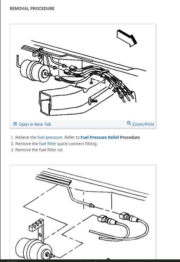

where is the fuel filter, how do I change it?
Jan 12, 2009 at 11:06 PM

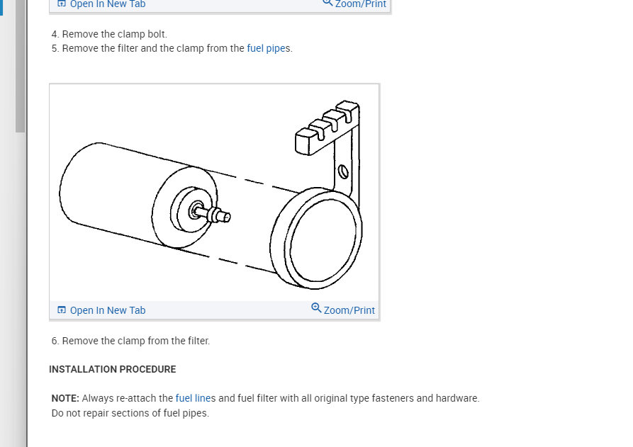

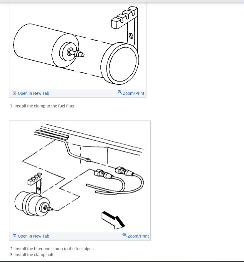

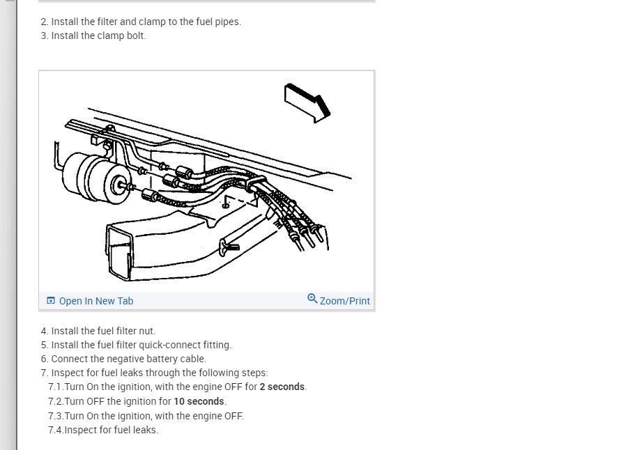

I am attaching the info from the manual on how to do this but here is a video that will show how to do it as well:
https://youtu.be/3RGTP2XUgp8
Plus, here is a guide that will help with other good info:
https://www.2carpros.com/articles/how-to-change-a-fuel-filter
Please see the info attached from the manual on how to replace the filter and let us know what other questions you have.
