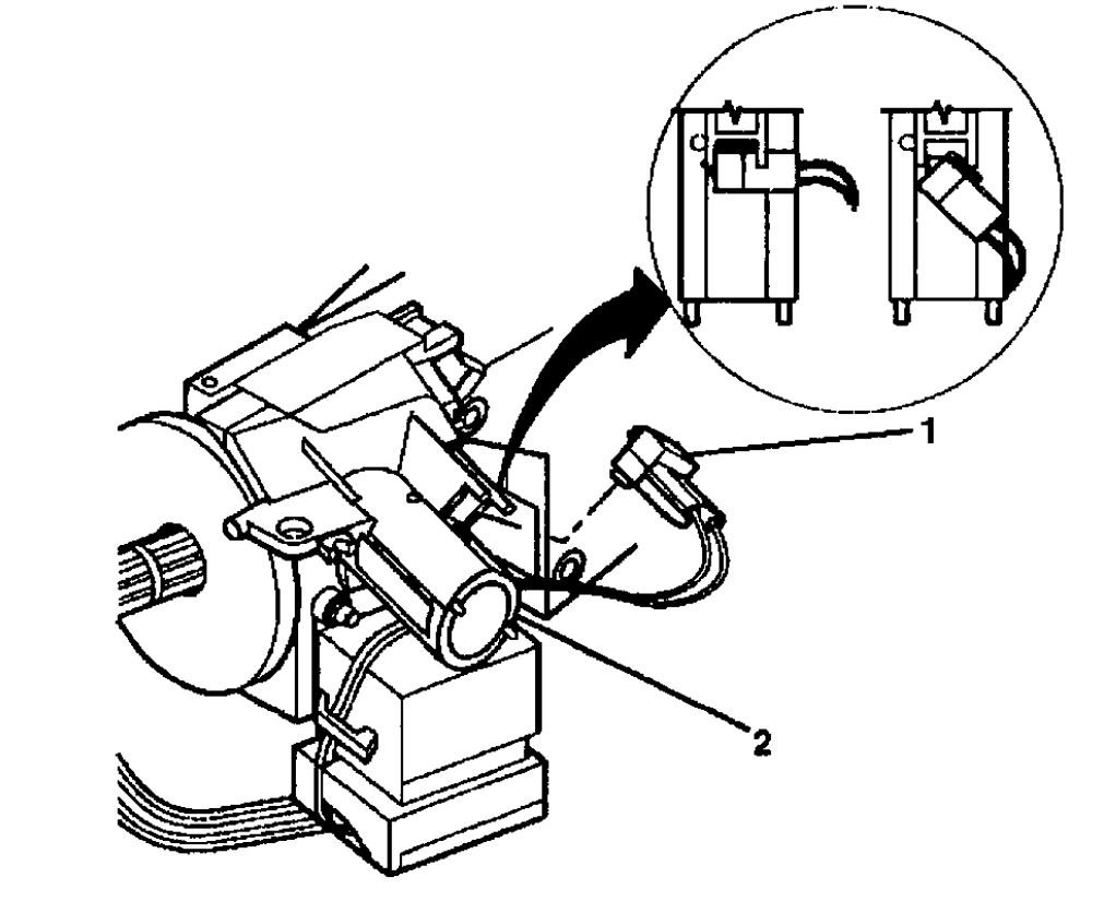

My truck will not stay running. It starts up then dies. The code P1632 came up (theft deterrent fuel disable) Is this some thing thst can be seasily fixed or is it expensive? tks

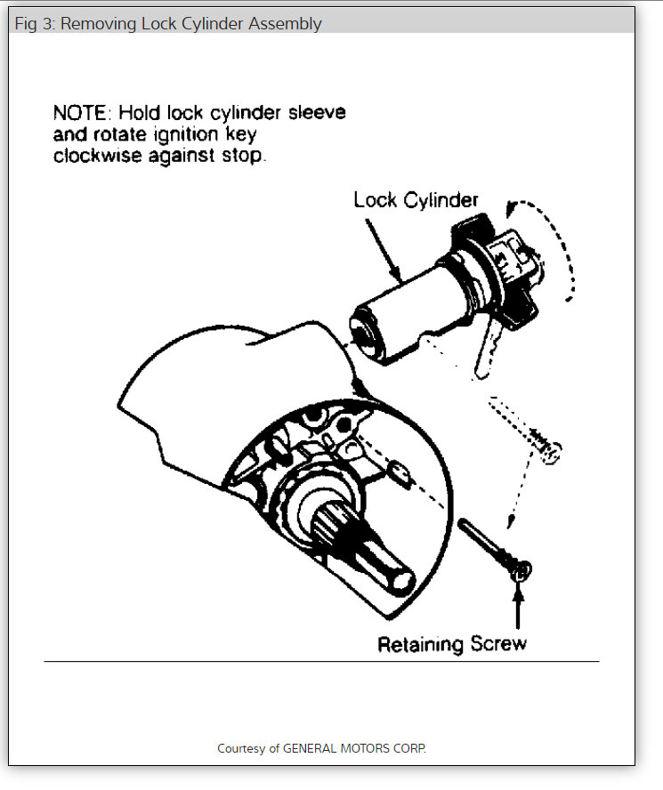

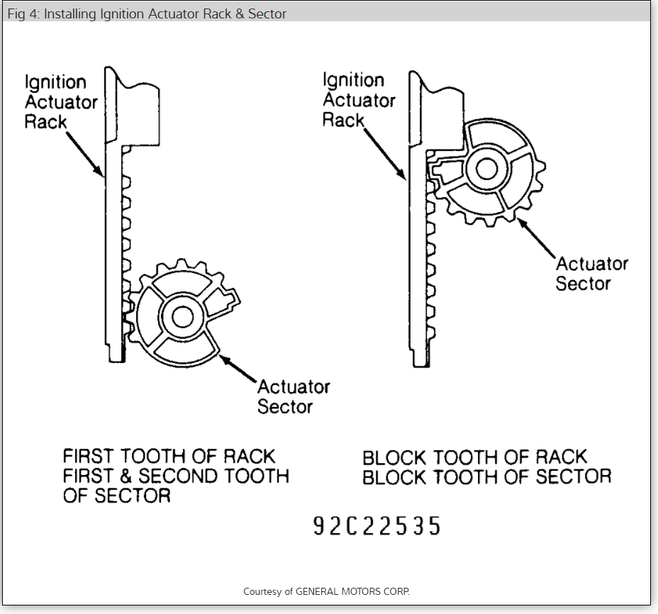

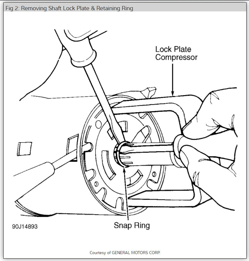

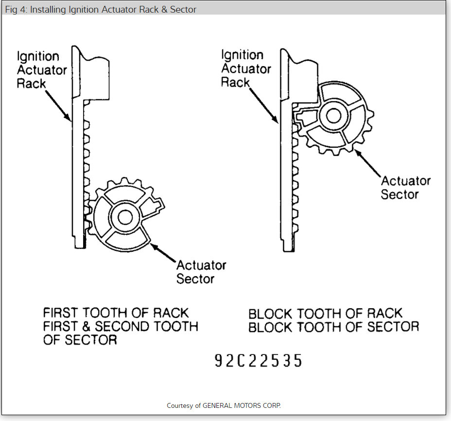

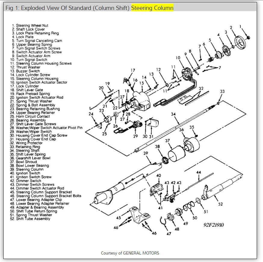

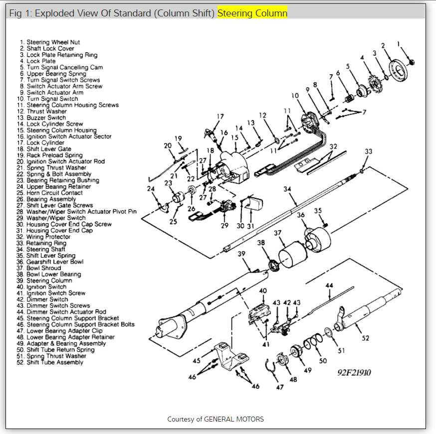

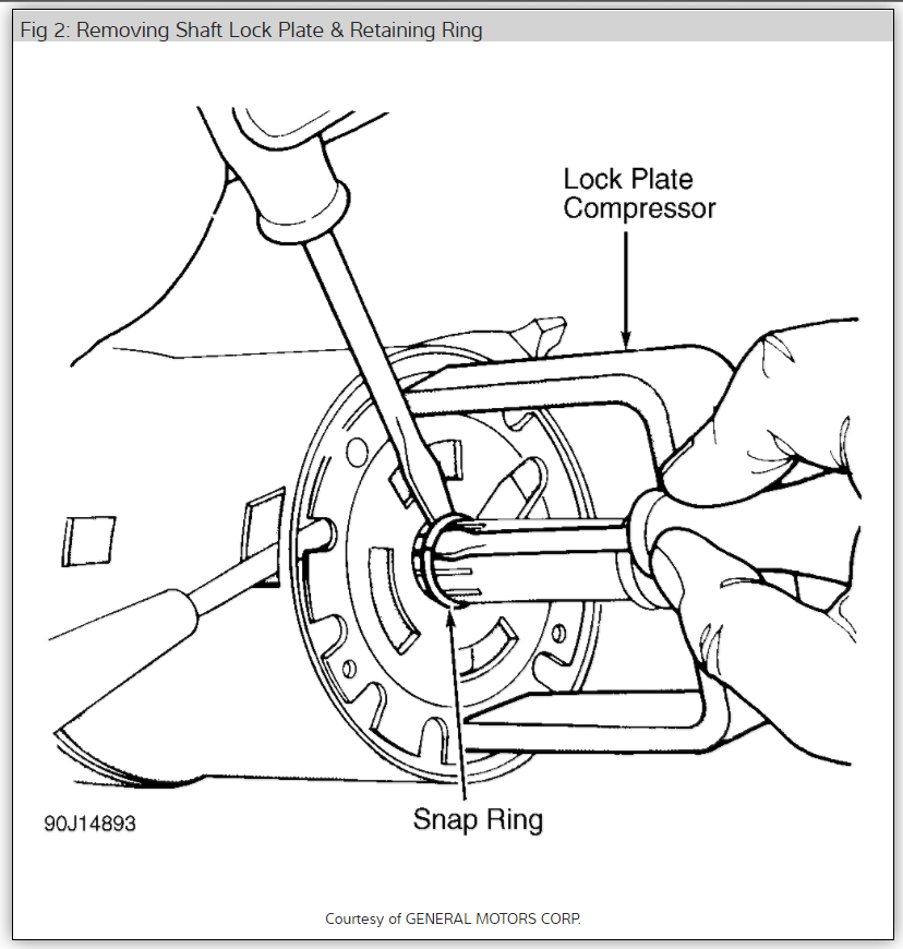

This problem is easy the the two small wires that go to the ignition switch tumbler bezel one of them has broken this is a common problem.
Here is what you are in for when doing the job (below) Check out the diagrams (Below)
