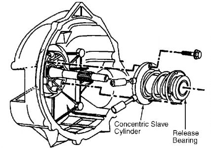

Hi. Just made a $20 donation, but submitted it before I was able to submit my question. Question: I have no resistance in depressing the clutch after hearing/feeling a "pop". Am not able to get the truck in gear. VIP mechanic says its the slave cylinder (which is internal?) and it'll cost near $800 to fix because entire transmission has to be pulled. Is this for real?

YEah it's for real. I would replace the clutch while I was there too. Looks like that price includes it.
https://images.2carpros.com/forum/automotive_pictures/30961_csla_1.jpg
