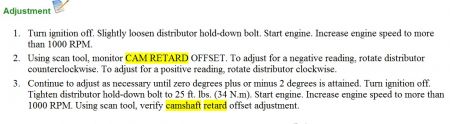

snap on scanner,,mt2500 scanner info, shows that cam sensor to crank sensor,, has diff of -14 degrees allthogh no code set ,,,, i suspect a worn out timing chain,,,am i correct?,,,,,in the snap-on parameter def. manuel,,, its call cam retard,,, thx

My info shows this for cam retard adjustment. If you can't adjust,yes, you will have to look elsewhere. Did you try to adjust?
https://images.2carpros.com/forum/automotive_pictures/170934_cam_retard_adjustment_1.jpg
